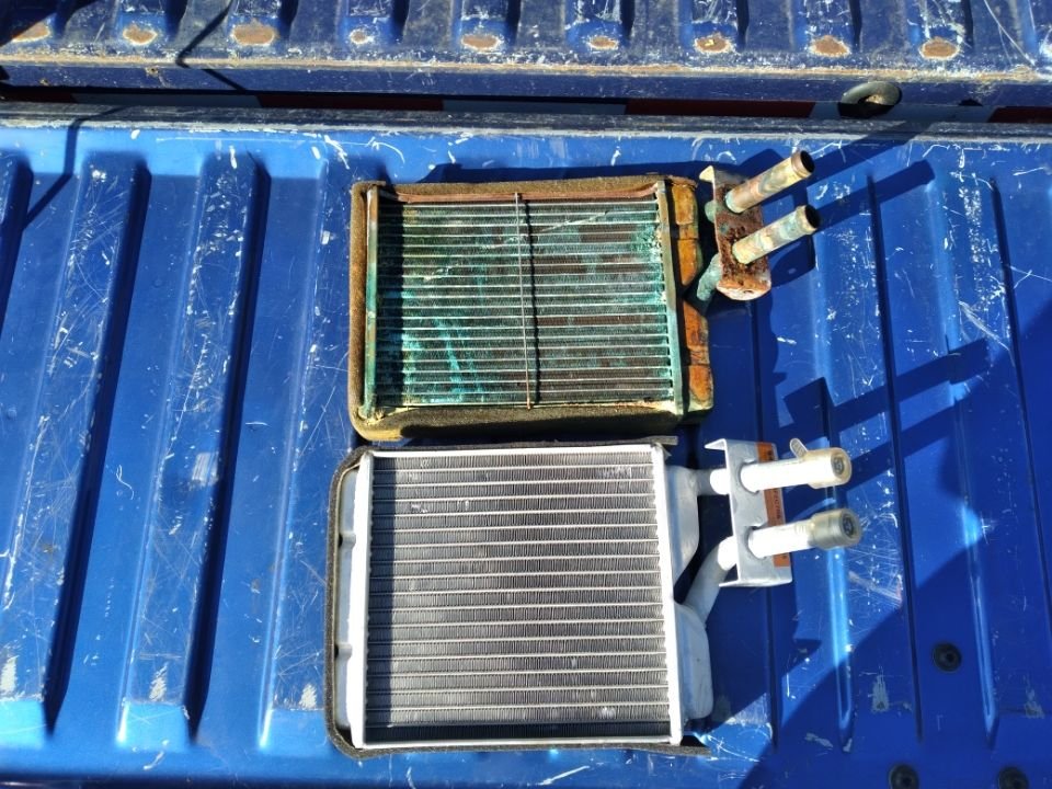

Where do these heater cores leak? Could you just recore one if quality replacments are obsolete?
I redid the core on a '97 Dakota last summer.
The cores usually leak when the seal at the end tanks deteriorates. Cores are available. I went on Ebay and there were quite a few available. You CAN recore a heater core. However, unless it is really rare, it's not feasible. A 1930 Deusenburg you might have to get one made.
The photo is my old and new cores side by side. You can see where the old one leaked by the traces of dried coolant. I replaced the a/c coolant core at the same time. Yes, the dash can be rotated down and the steering column dropped,, but I removed both and did a heavy clean and restore to the dash area. I even scrubbed the plenum box where the cores go to get the cigarette smoke smell out. Scrubbing with window cleaner I had a yellow stream of nicotine running out of it.
