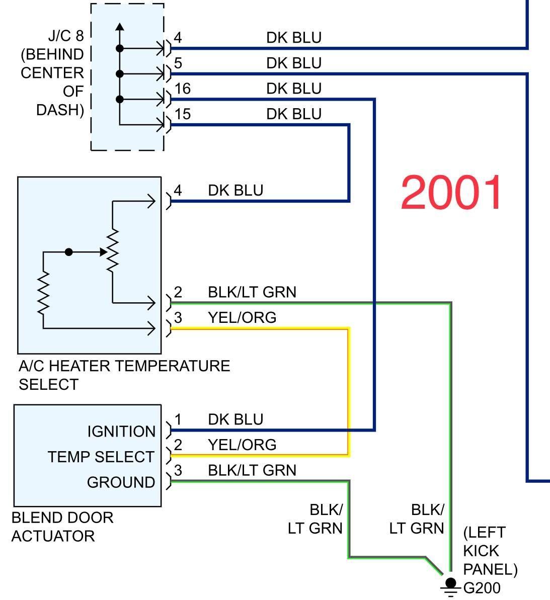

You may want have a look in the service manual but i believe the temp **** is potentiometer, This tells the actuator witch way to move. If there is dead spot in the pot it may stop the actuator from moving. I found this on the net...

well I’m ashamed to admit it but this picture means nothing to me. I know nothing about reading schematics. But what you said makes sense.
A while back I replaced the bezel on my dash and had to remove the temperature control panel to replace a vacuum hose. I’m wondering if maybe I did something to a connection? I’ll have to investigate this.

Ok there is a dead spot! If I turn it all they way Donn to cool it won’t go back up. But if I stop about a quarter inch from cool it will operate as it should. I can live with that! Thanks for your information, it helped a lot.
