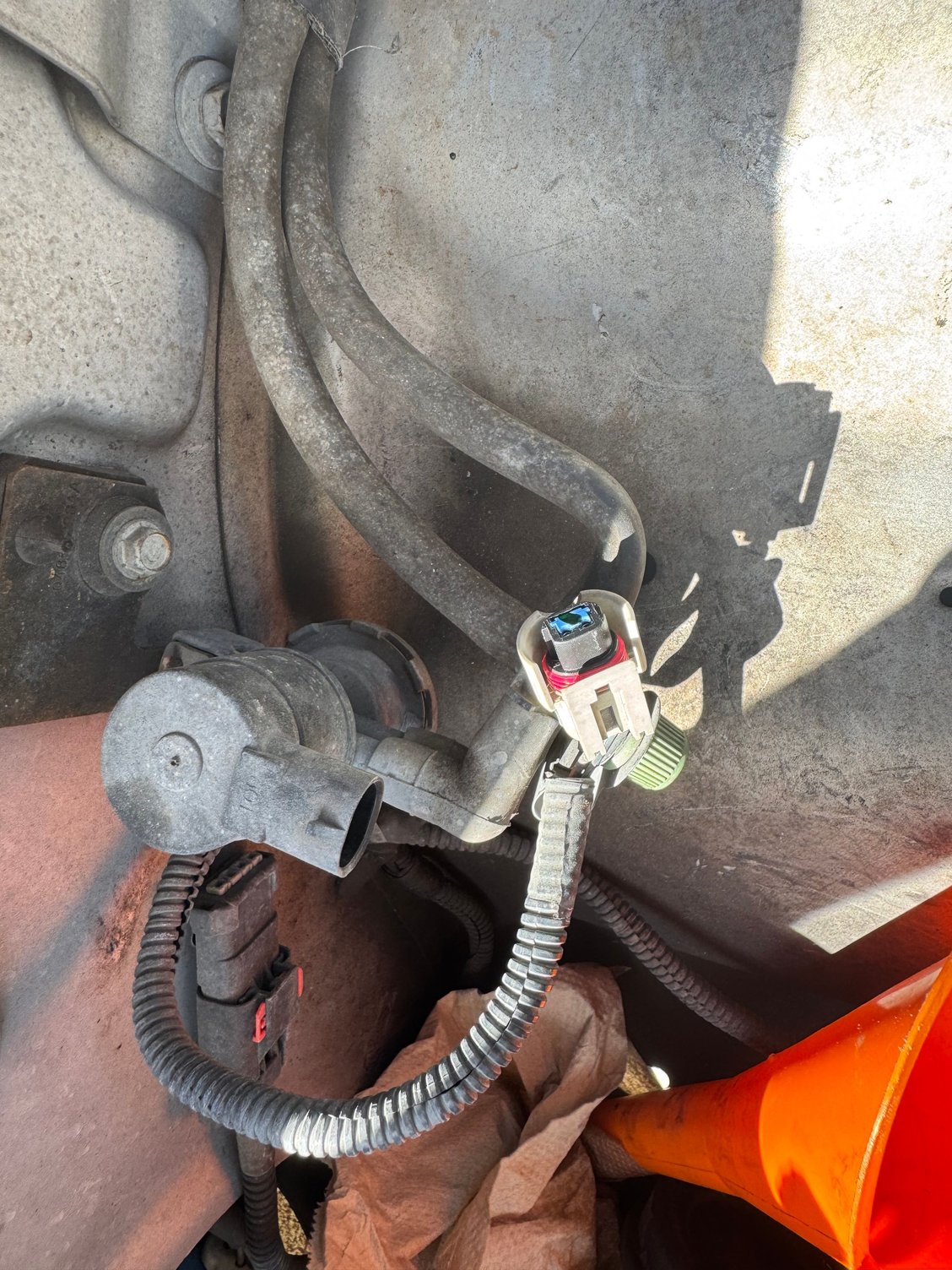

Originally Posted by dodgetruck2
Its for the EVAP purge, i believe its mounted to the charcoal canister down by the fuel tank
I attempted to find the wiring to the evaporator purge and closest I got to was this plug in the engine bay leading to the canister area. Took a picture of the top and don’t see any electrical plugs but did find a hose that’s dry rotted and most likely why it’s throwing that code?
Purge valve in engine bay? Leads to canister but cannot find where the plug is
I attempted to find the wiring to the leak detection pump and closest I got to was this plug in the engine bay leading to the canister area. Took a picture of the top and don’t see any electrical plugs but did find a hose that’s dry rotted and most likely why it’s throwing that code?
