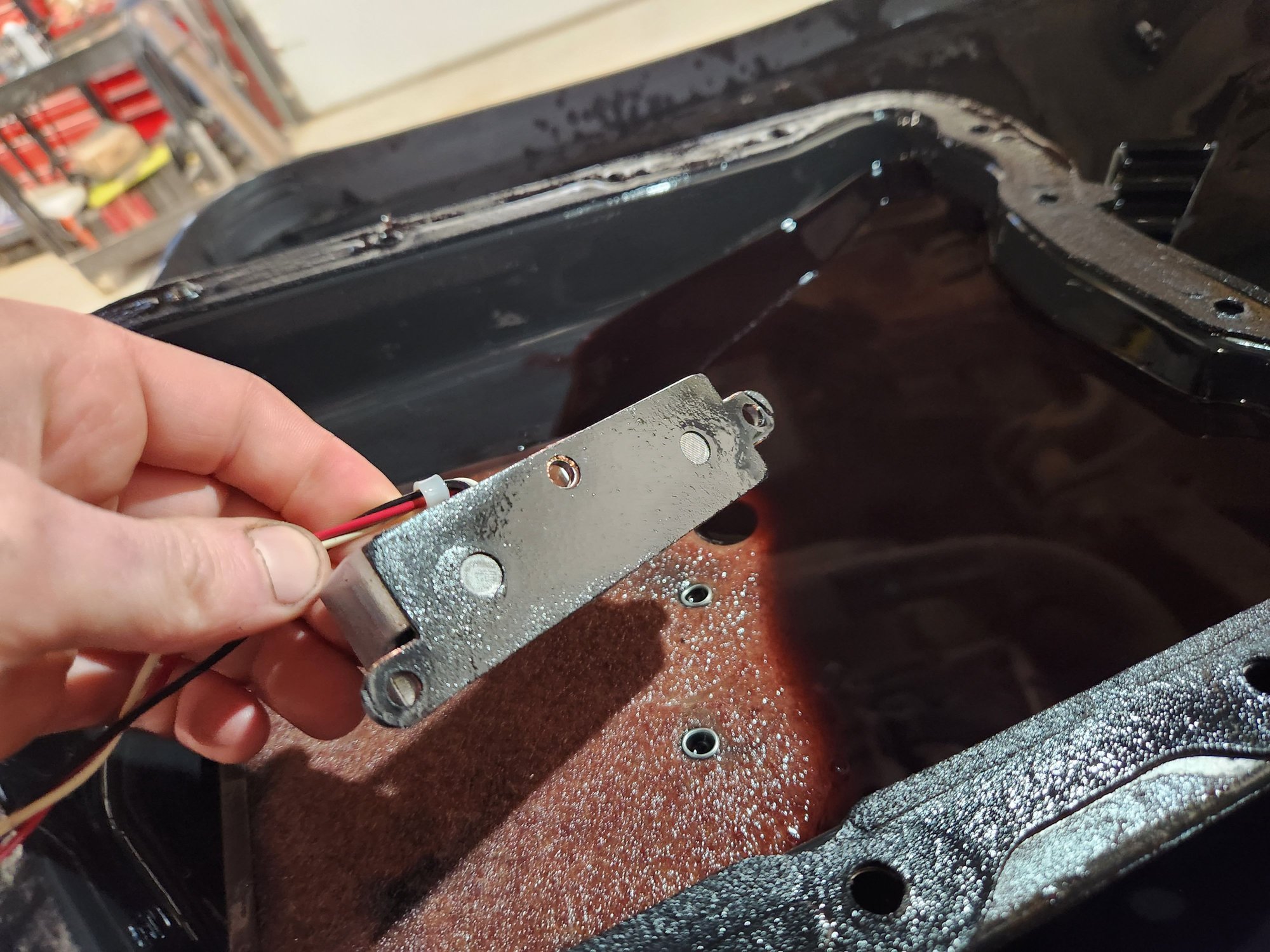

Ok, I did a pressure test on the rear servo. With the transmission in R, the pressure was between 150-160. It was a little unstable (needle was vibrating), but it stayed right in that range, until I shifted out of R, then it dropped to 0.
I went ahead and dropped the pan, just to see if I could see anything obvious. Pulled the solenoid, looks fine, but how do I know if it's leaking? There's no O-ring on it, just the flat gasket where the assembly meets the valve body. Same with the OD accumulator. I don't see anything wrong with it, but how do I know? I really want to fix this thing, but I'm approaching the end of my expertise.
Where do I need to look for a leak?
The back of the OD/TCC solenoid assembly.
Accumulator piston.

The o ring on the accumulator looks flattened out, Are they hard?
Old Mar 26, 2025 | 06:56 AM
BohemianEngineer's Avatar
BohemianEngineer
Joined: Mar 2025
Posts: 10
They aren't o-rings, they're square seals. There's an angled split in them so they can be opened up to install.
