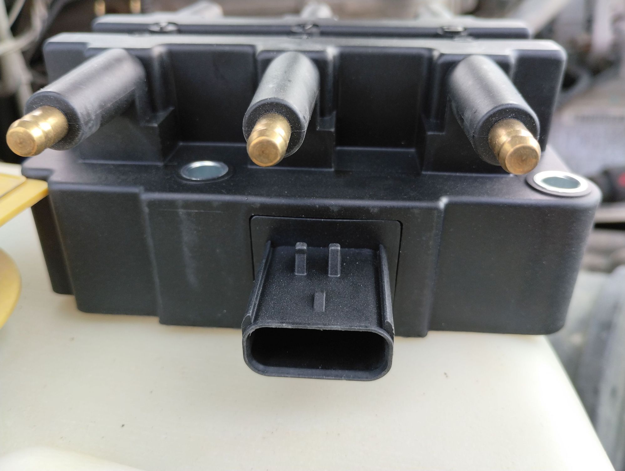

Okay brain trust, who has dealt with this problem. I know the engineers hate us, but whoever was tasked with this must have had an argument with their wife the night before. I have attached a photo of a brand new, OEM coil pack for the first four cylinders of my V-10, 2001 2500. I need to know how to remove this thing..I can see the tops of the two tabs, I ran a tiny flat-bladed screwdriver right up the middle from the bottom, but all it did was push up the dust under the bridge doing nothing. There is no room on the sides so I don't understand the conformation fo the retainer.

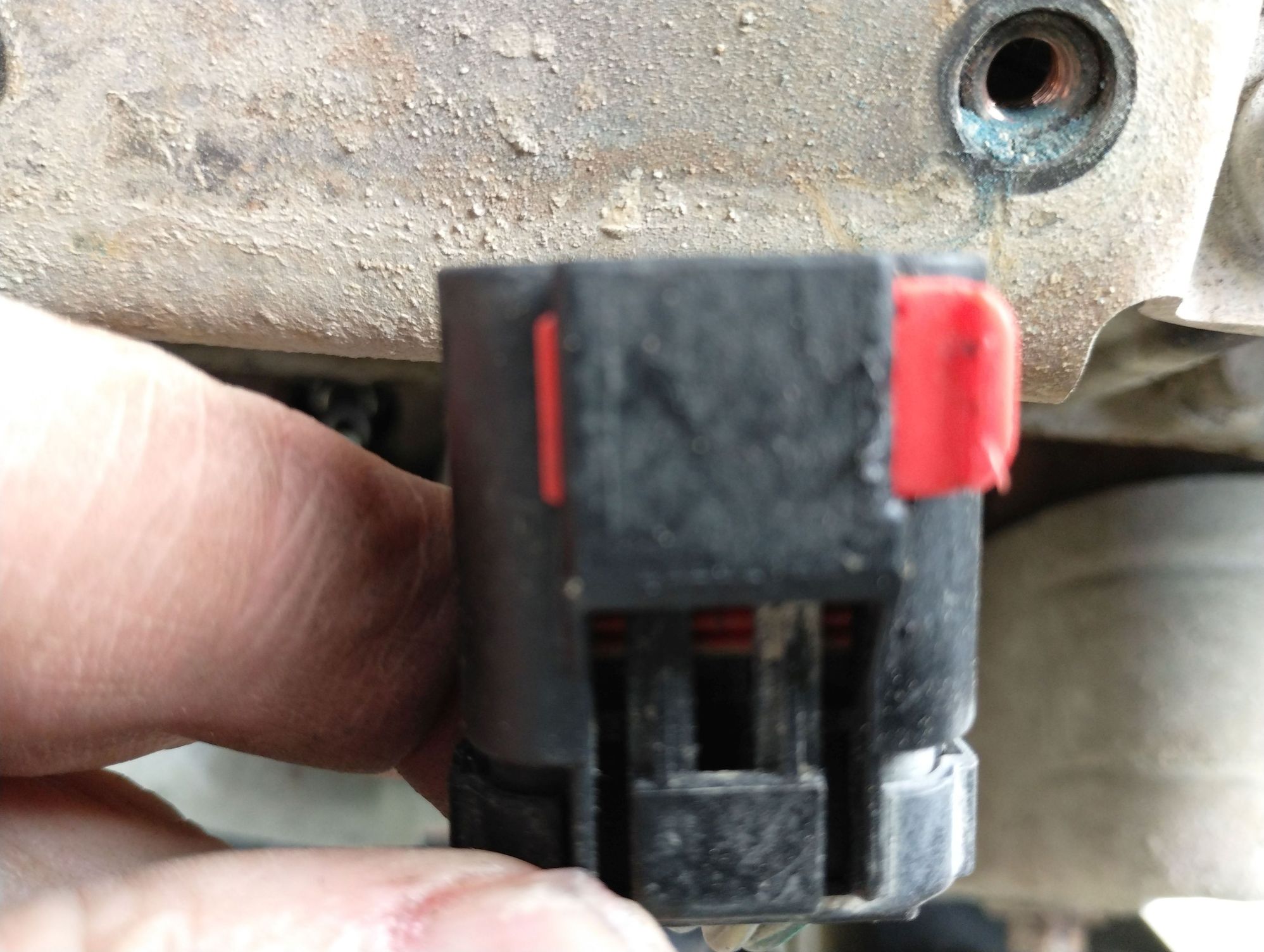

You can see the parts of the molded in locks. They are a little off to the side, suggesting something is different about the plug retainer.
This is what you see of the plug untouched on your V-10 coil pack. You must first push the right hand side over to the left to exposed a small space because your nemesis is waiting for you.
This is what you see of the plug of your V-10 coil pack plug when it is pulled off.

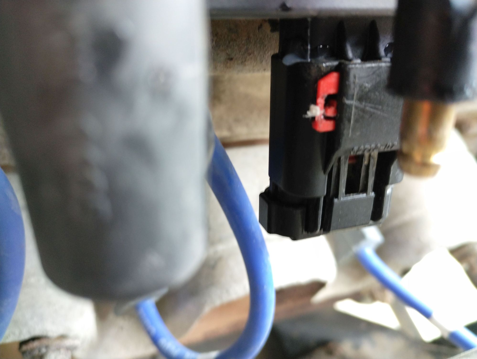

This is what your fighting. See that tiny red tit peeking out? Use a small dental pick to very carefully pull it DOWN while you simultaneously push UP on the plug, then push the red
This is what your fighting; this is the tab fully to the left in the locked postion. See that tiny red tit peeking out? Use a small dental pick to very carefully pull it DOWN while you simultaneously push UP on the plug, then push the red "U" over towards the right. When it is fully to the right, press on the plastic tab at the bottom of the plug, this is the second lock, it doesn't take much, but if you don't perform this ballet in sequence, it won't come off and you'll end up using unnecessary Power Words best kept in reserve for busted knuckles and such, pull down and remove.

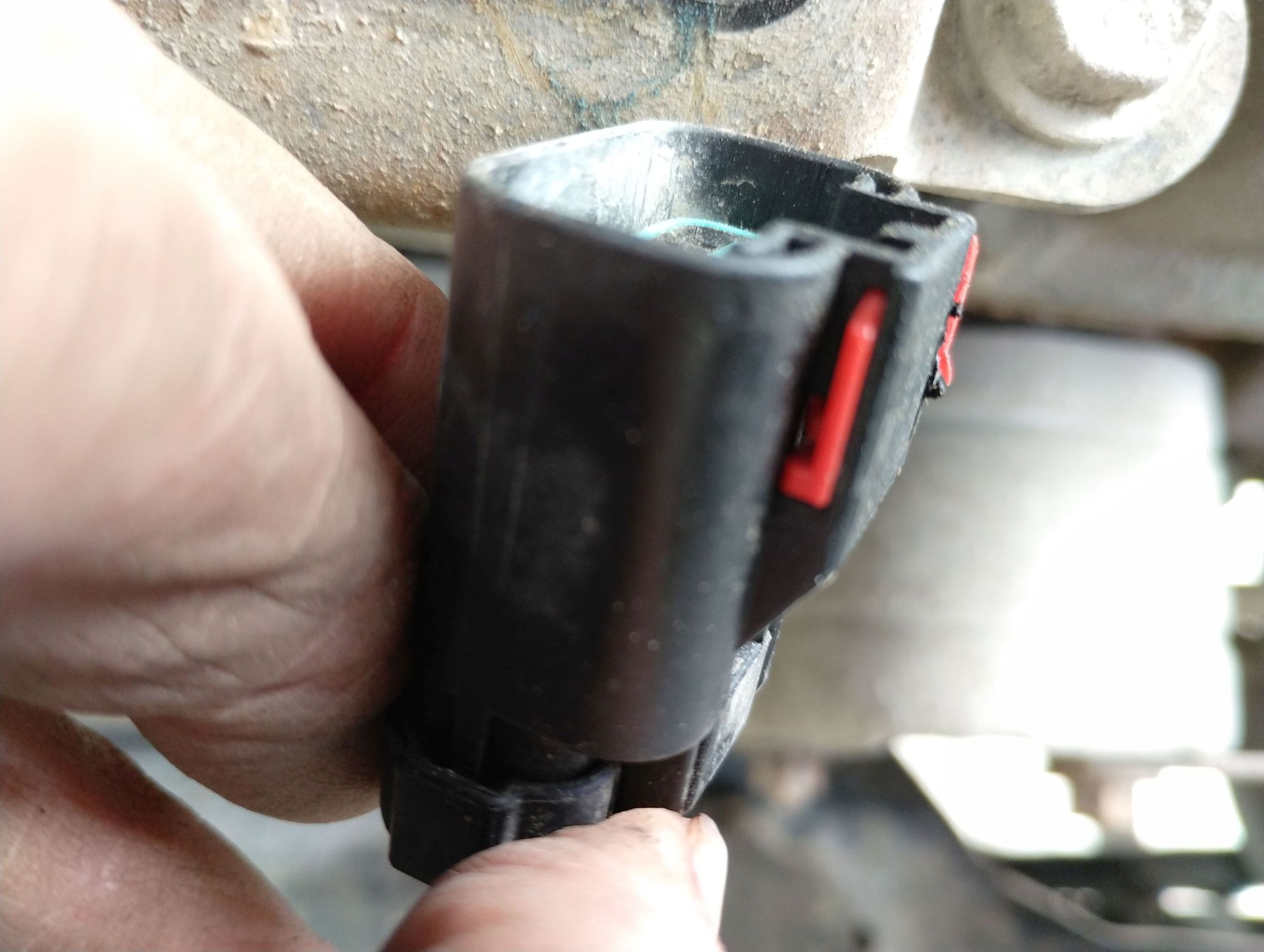

This is what you see when you look at the side of the plug with a dental mirror. So: use a couple drops of Kroil to help ease things along, can you see the tit just above the bottom of the
This is what you see when you look at the side of the plug with a dental mirror. So: use a couple drops of Kroil to help ease things along, can you see the tit just above the bottom of the "U", it's soft plastic, so be careful. Pull it down while sliding the female end up onto the male snout on the coil pak, you'll feel and hear a tiny click, do all these things: push up, pull gently down on the tit, when it clicks, push it right to left and it will lock the plug in place.
