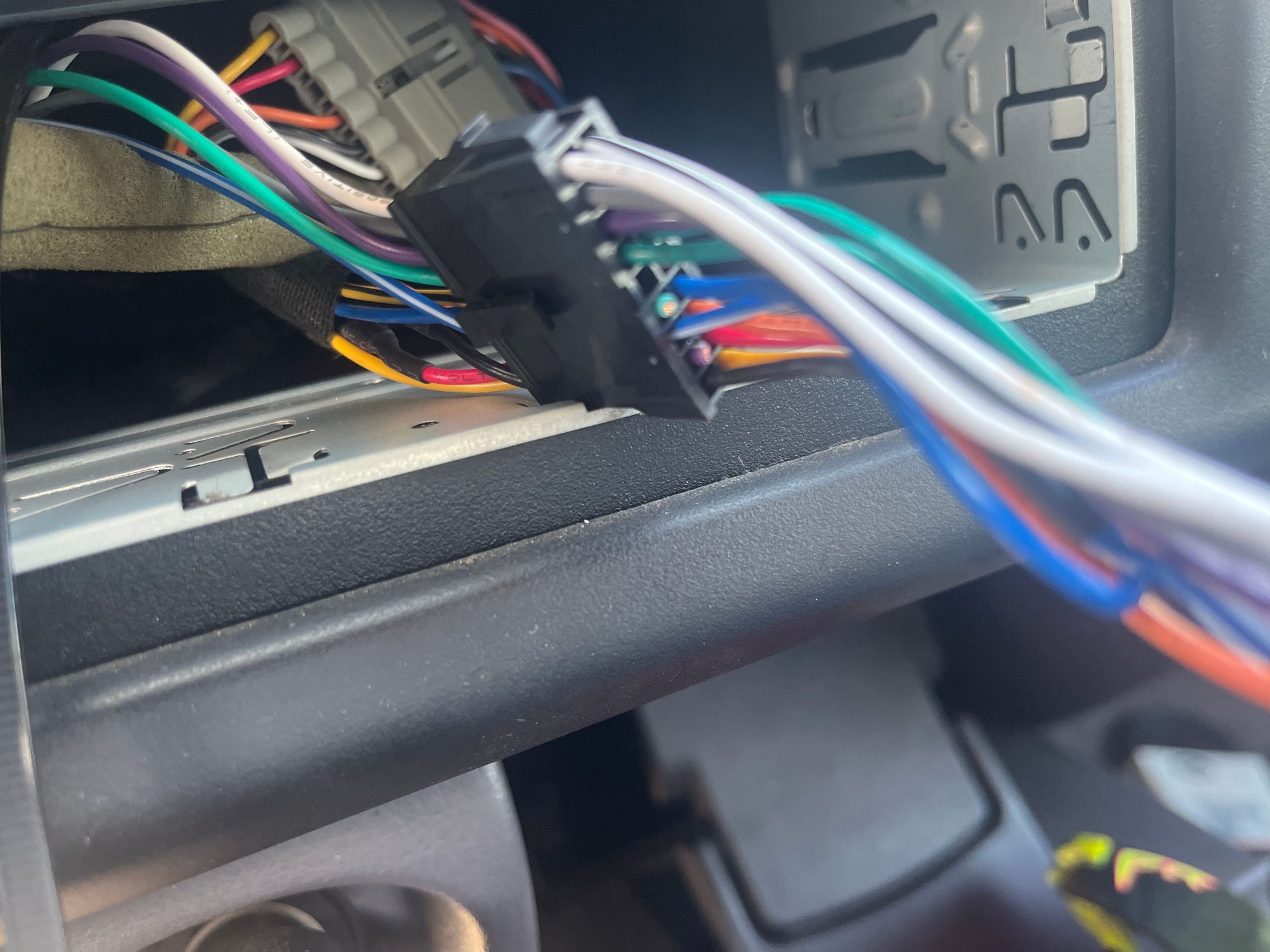

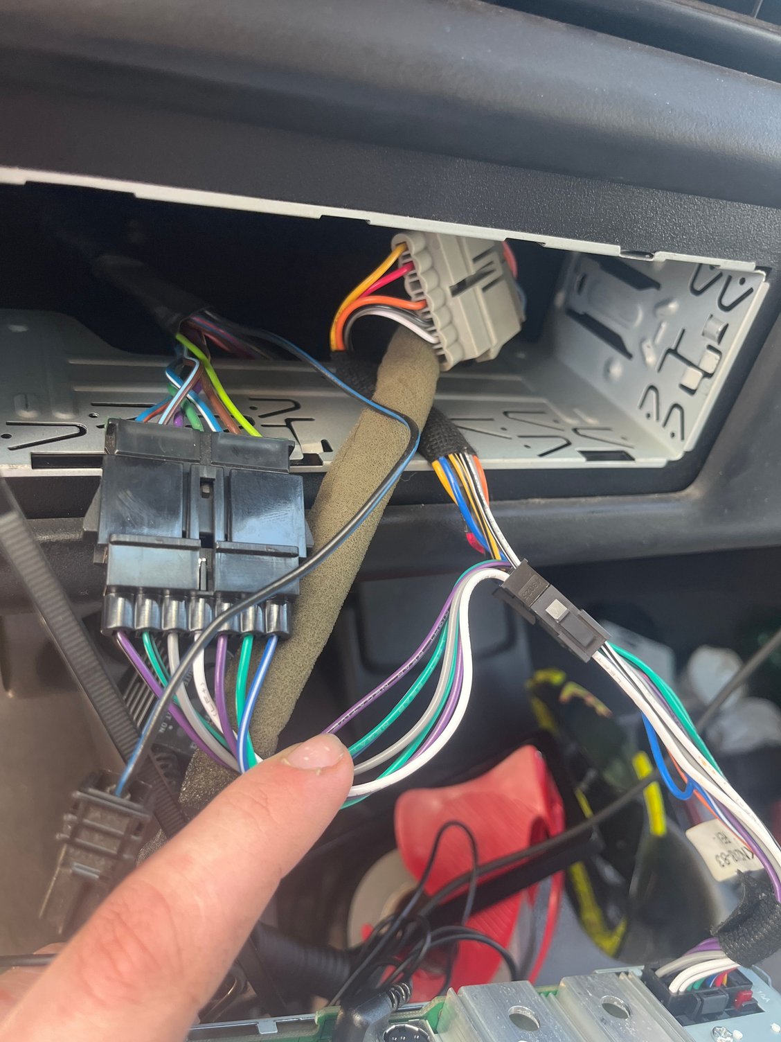

Yea the green is just disconnected on here. Let me take a picture.
where would I connect this to give the amp power or whatever it needs

Originally Posted by Bob smit
The light green wire on the right side of the black connector is the one that controls the relay. It should connect to the "power antenna" output on the radio which has 12V when the radio is tuned on.
I suppose you could remove the power amps at the speakers and have the speakers connect to the radio directly. No idea how easy that is. Worst case replace the speakers with regular ones.
Edit: I just looked at the wiring diagram for the relay, the power for the amps comes from fuse 4 in the inside fuse panel. Check that as well.
