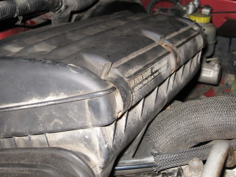

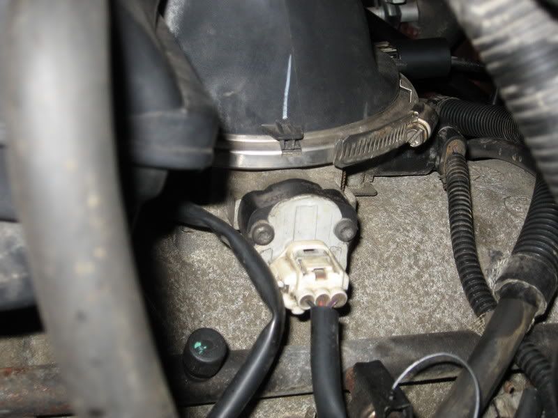

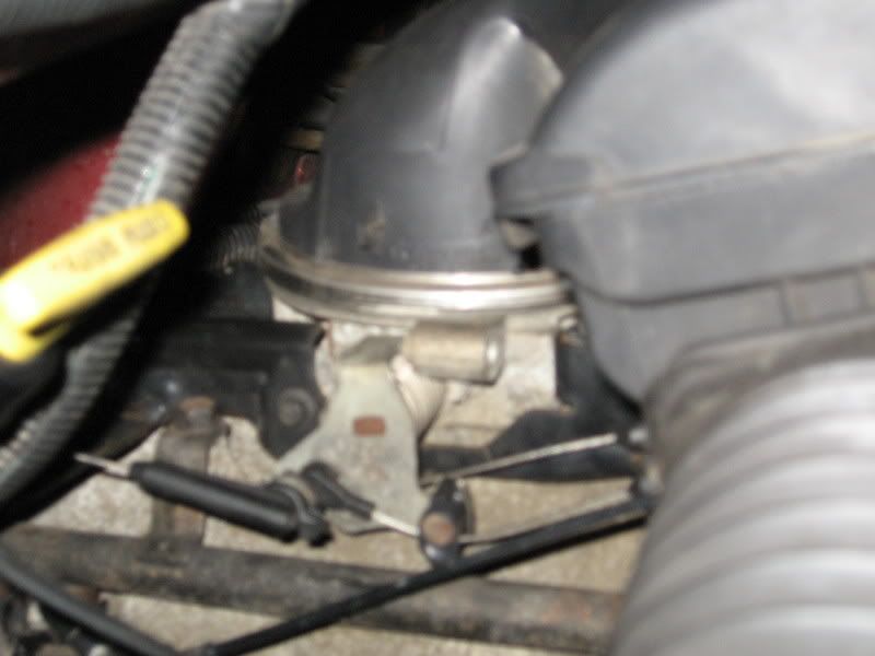

nope i have a purolator replacment. the tube is as tight as i can get with a screwdriver. i don't have a gasket between tb and tube. see pics.

You definetly SHOULD/MUST have a gasket between your T/B and aircleaner or it will leak and make that sound. Plus, you're rendering your filter useless because all the stuff you are trying to keep out is going in there!
Air cleaner gaskets are the forgotten gasket on a lot of rigs...

That was the problem! put it on and all is well. Thank you
