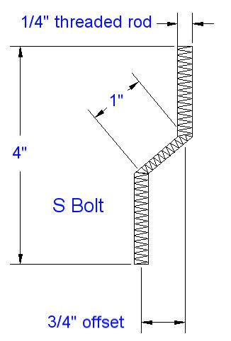

Make your own S bolt from 1/4" 20 threaded rod
Need 5 1/8" opening in the base
Max as far as I know is 1/2 drop on the base and that will allow you to use a 3" tall filter.
If you have a 52mm tb the S bolt needs to be a bit longer.
http://www.rm-indy.com/Installs/sbolt.jpg

Dont waste your time with the tb spacer, put it on ebay. You will not be able to fit the 14x2.75" filter under your cowl if you add the spacer. To get a filter that size to fit, need to have a 1/2" drop base.
The threaded rod screws into the hole between the 2 butterflies.
http://www.rm-indy.com/Installs/52fastman_top.jpg
