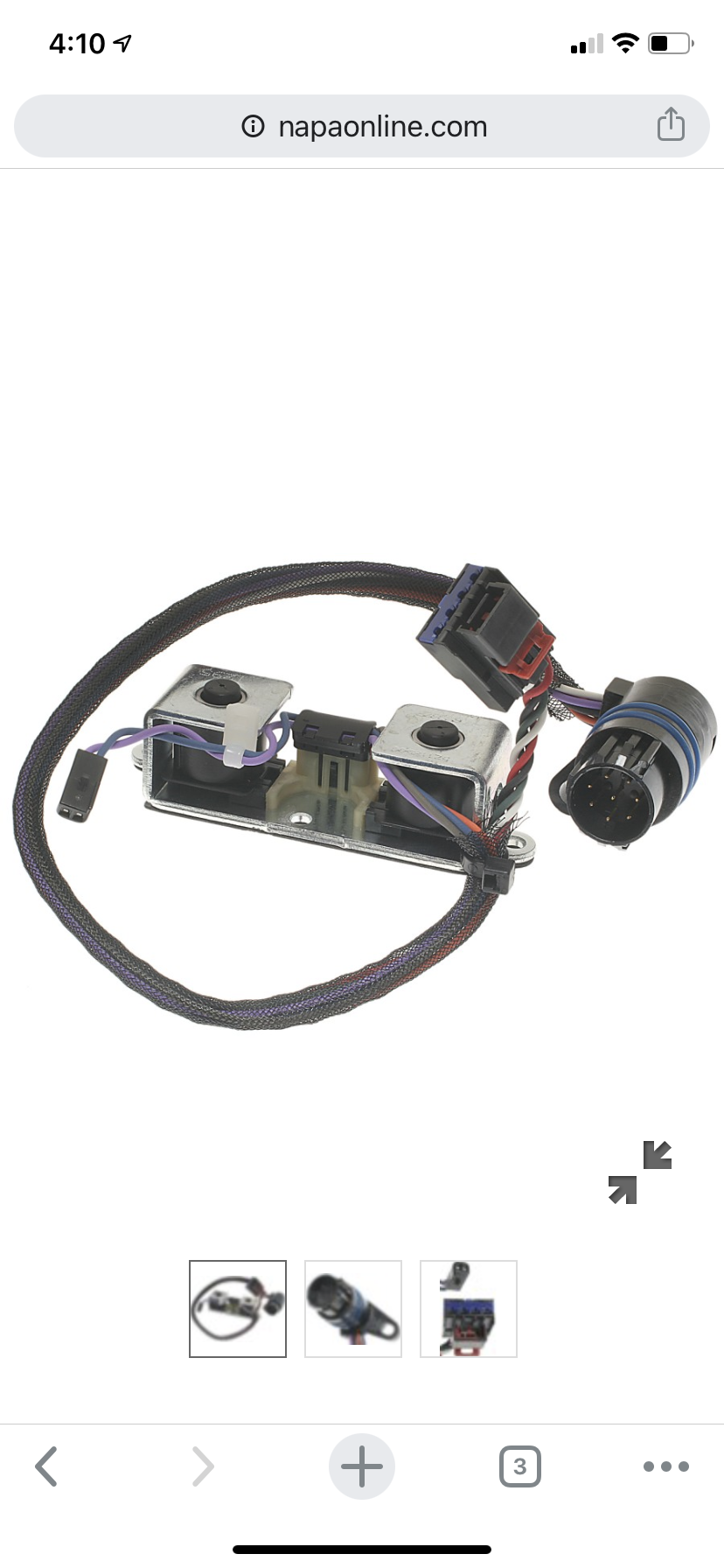

I have an 05 Dakota 4.7L 8cyl that is running code p0700 and p2706. I am getting ready to replace the shift solenoid, but when I search them online I get a few different results.... not sure which one I need. I have attached the images of my results below. Thanks in advance!

Top one. Our solenoids are in packs that are mounted to the valve body.
Do you have a copy of the manual? Only asking because solenoid packs are pretty expensive, and the manual says P2706 it is strictly an electrical issue, not to do with the internals of the transmission.
