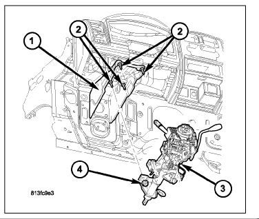

14. Remove the upper steering shaft coupler bolt (2) from the column (1).
15. Separate the shaft from the coupler (7).
16. Remove the four steering column mounting nuts (4).
17. Remove the steering column assembly (3) from the vehicle.
18. Remove the bolts (2) from the pedal support (1).

nice, the pics help a lot. The only area where I think I might have trouble is with removing the shift cable from the column shift lever actuator- probably just sounds more intimidating than it actually is- should I reconsider doing this considering that I do not know where in the vehicle the diagram for this procedure is illustrating? If this does not go well, you guys might see my truck for sale- parts only on this website j/k.

It should be on the steering column inside the truck once you get that cover removed.
