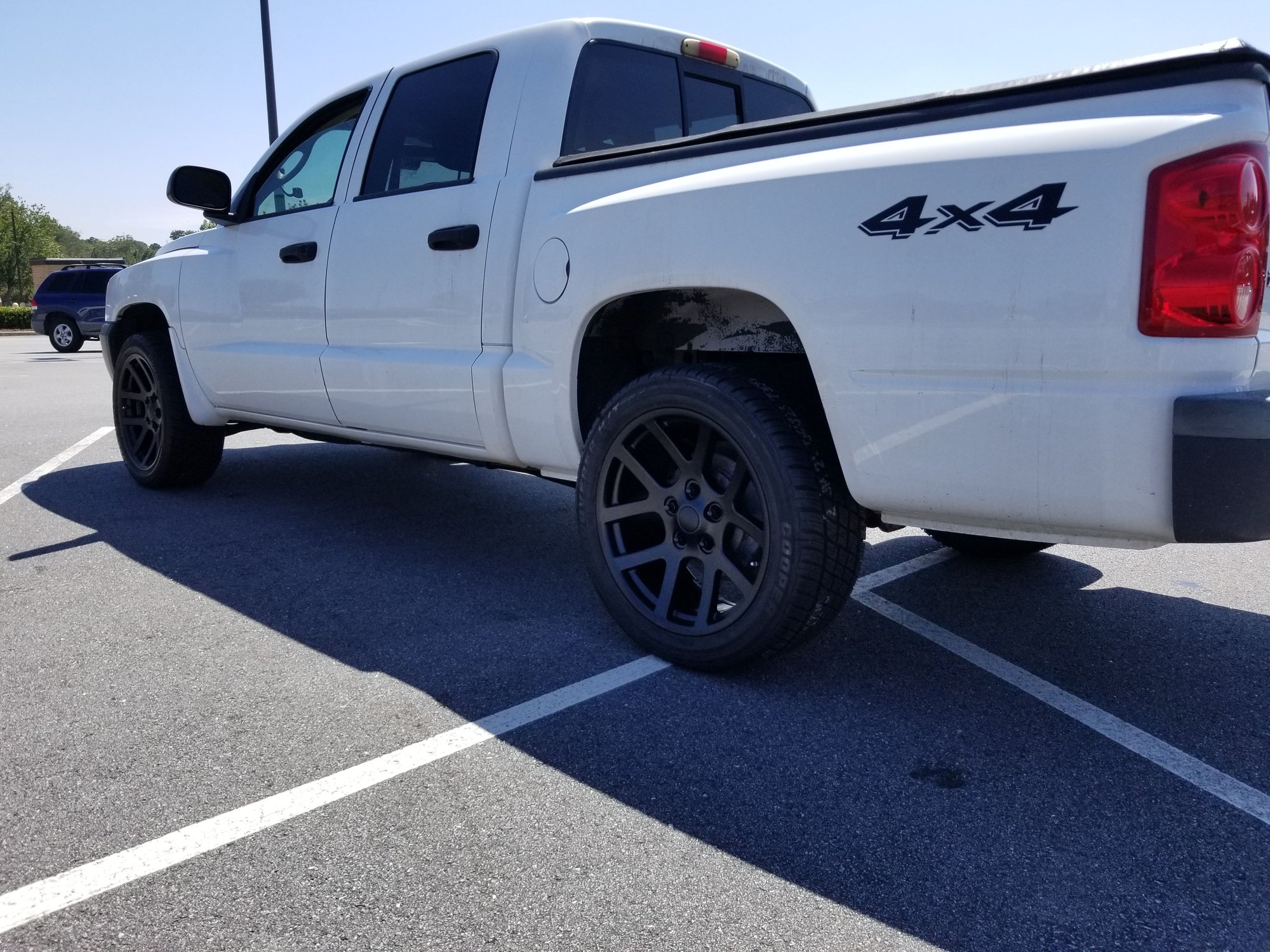

Default SRT10 matte black
I finally bit the bullet and upgraded the wheels.
SRT10 Matte Black 20"
275/45/20 Cooper Discoverer H/T Plus

Love the SRT wheels, great choice.
I see the 20 inch wheel setup is not in the first post, maybe it's somewhere in between, but here it is again.
3G Dakota tire sizes with factory lift
-275/45/20
-265/50/20
3G Dakota tire sizes with 1.5" or 2.0" leveling kit with slight trimming
-285/50/20
