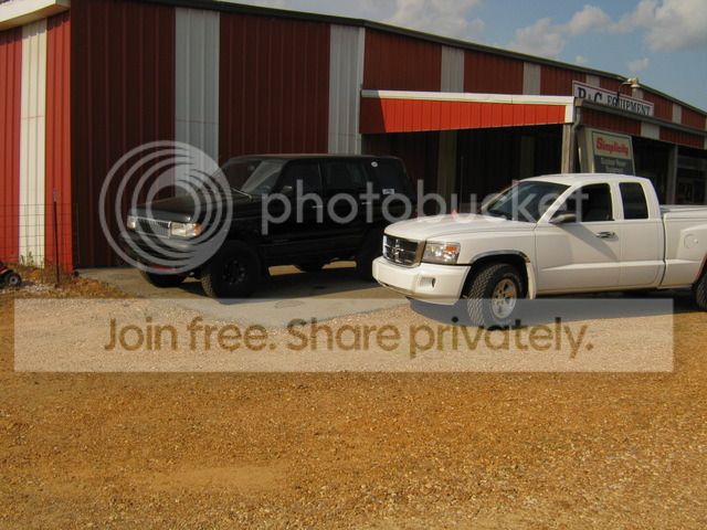

For rear coil springs I am thinking of factory orriginal equipment Isuzu Trooper rear springs. They are soft springs and ride buttery smooth.
If you ever get the chance, go test frive a '92-'98 Isuzu Trooper. They ride buttery smooth. If,,,,,IF someone has not swaped out the factory suspension for upgraded heavy duty stuff like mine is! But mine is an off road BEAST!!!!
Here is a pic of my 'Kota sitting beside my Trooper:
