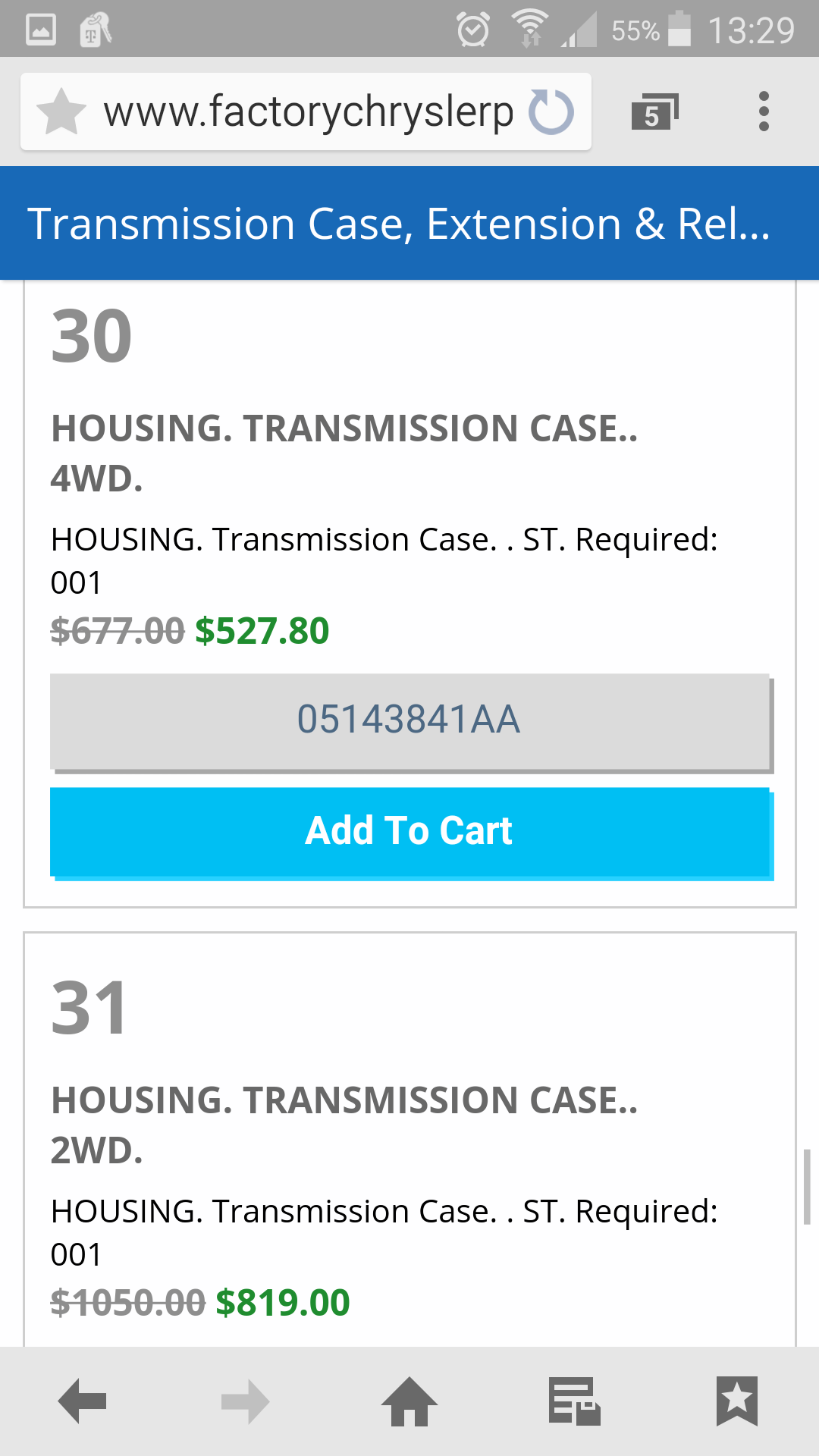

Doing some research into the conversion and I find this. Shows me 2 different types of transmissions.
Can some explain to me the difference in these cases? Will I need to change my transmission case housing as well?
From what everyone is saying the transfer case is a direct bolt on but this is throwing me for a loop...

The extension and tail peice are the only things you need. The transmission is the same. You need to get rid of the yoke setup from the 2wd to the spline setup so you can bolt up a transfer case.
