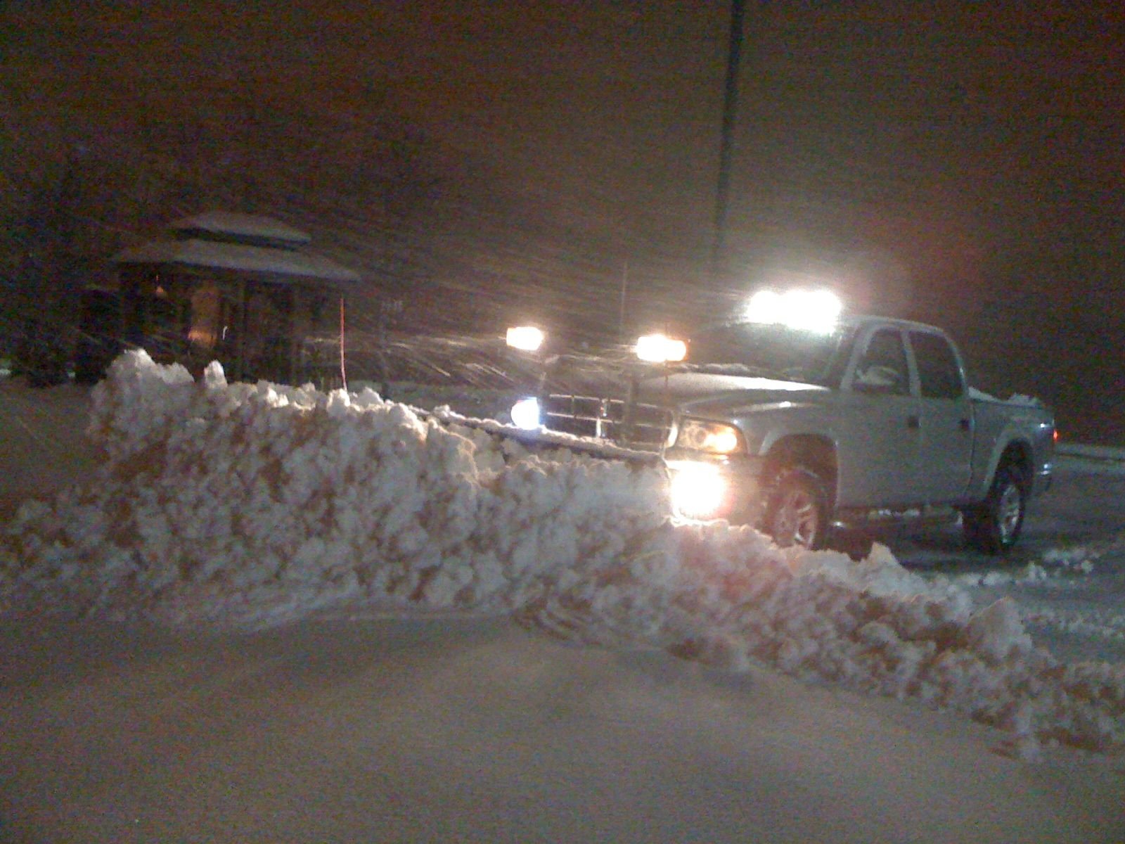

I've had an 03 Quad 4.7l V8 that I've plowed with for years. That truck had a 4.7, 4wd, 9.25" rear, etc like this one. I'm thinking the plow itself is not helping with airflow into the front because the radiator sits lower and is thinner really.
