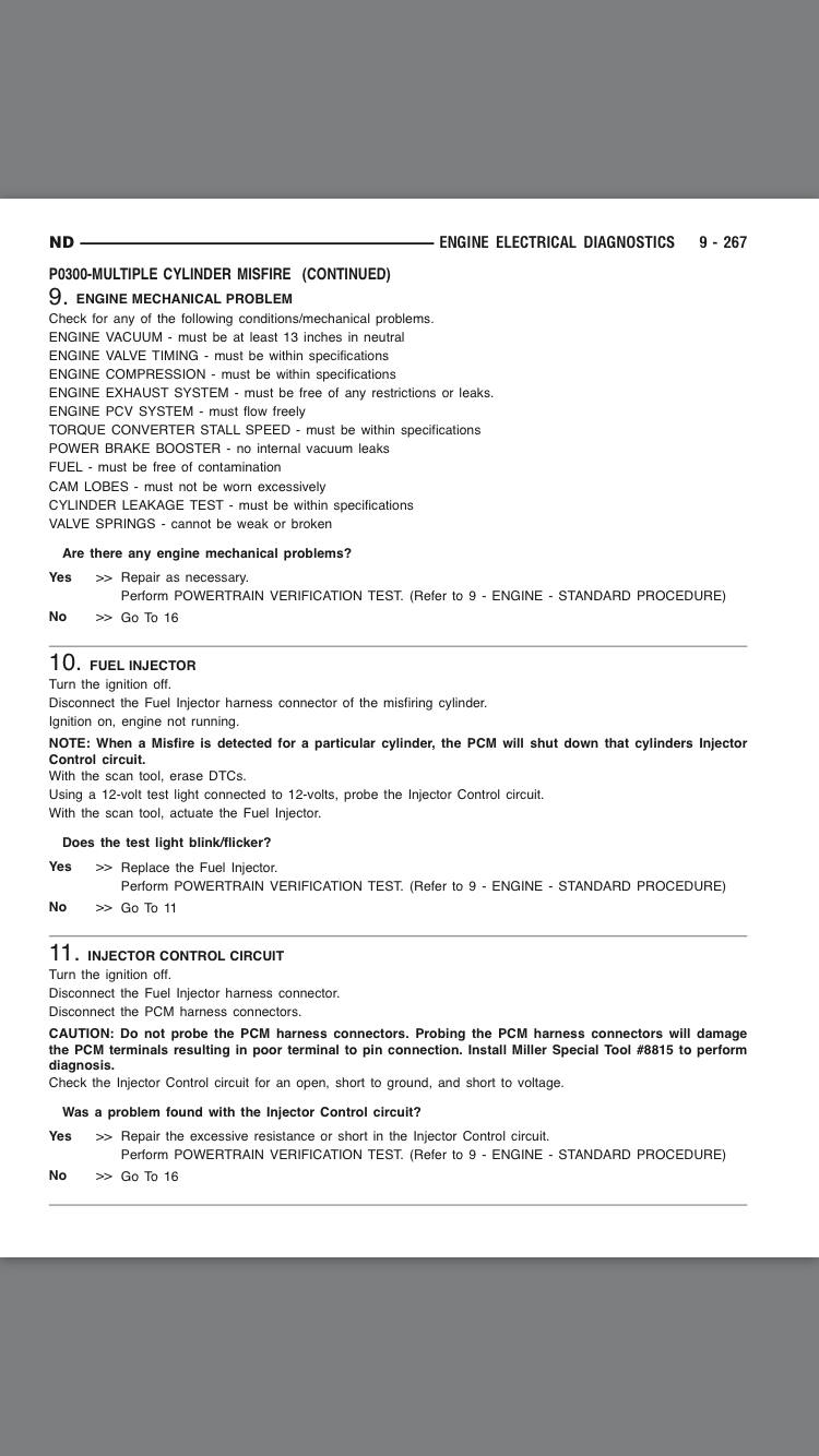

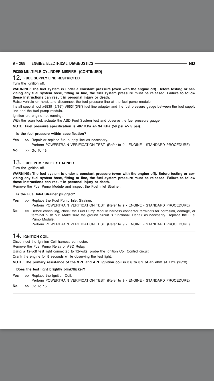

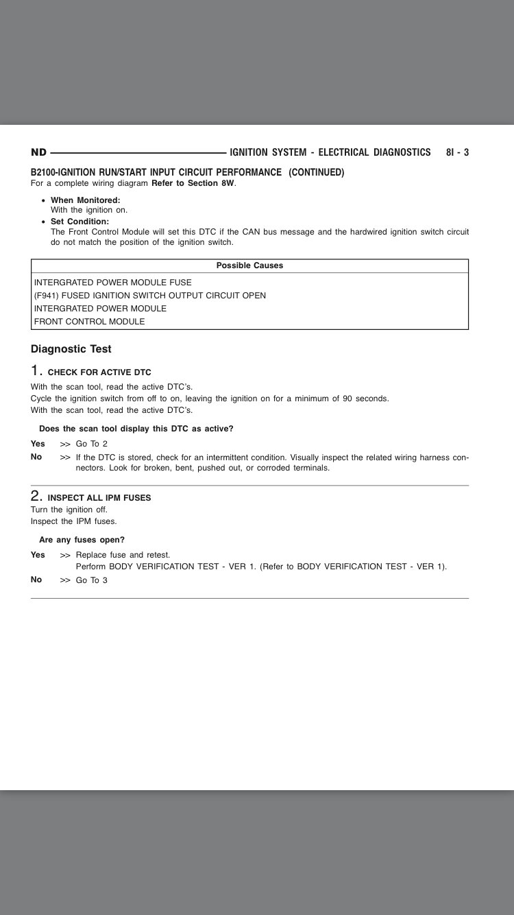

Pulled this from the dealer service manual, hope it helps out. Let me know what happens and if it fixes the problem your having. I'm experiencing a similar problem, no codes yet for me just the guessing game.

Any luck with the problem you had. Just wanted to see if you fixed it, might help me better troubleshoot my ongoing problem.
