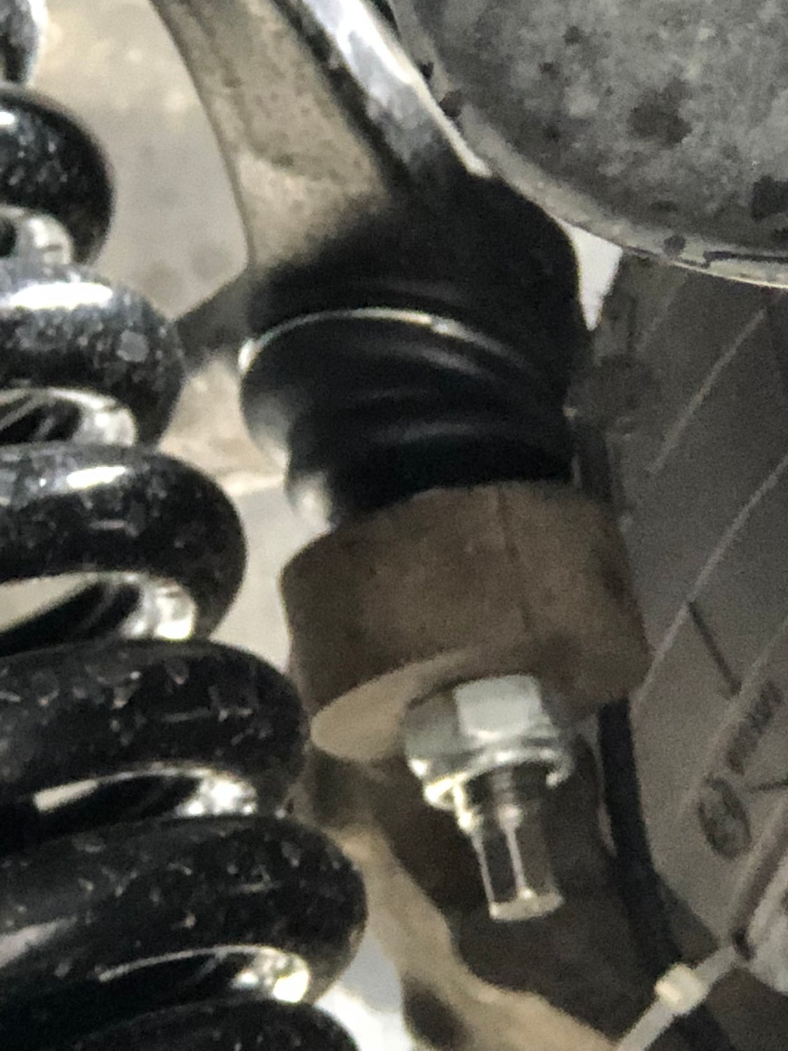

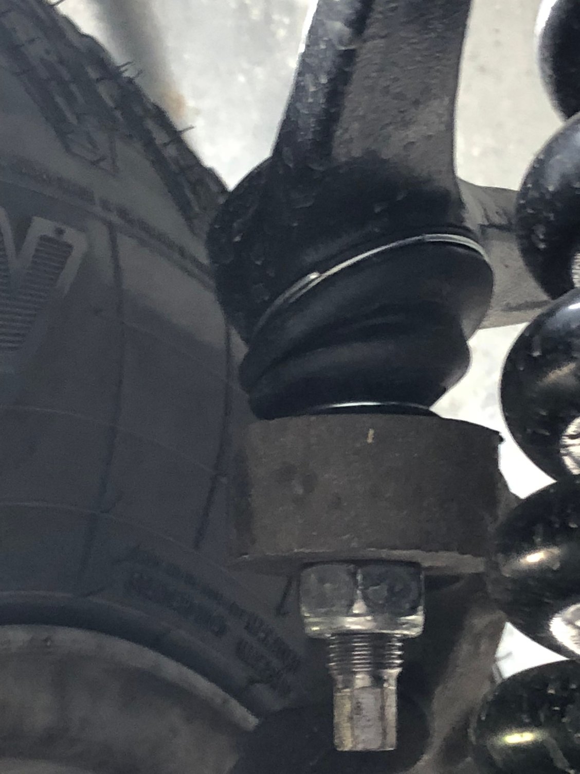

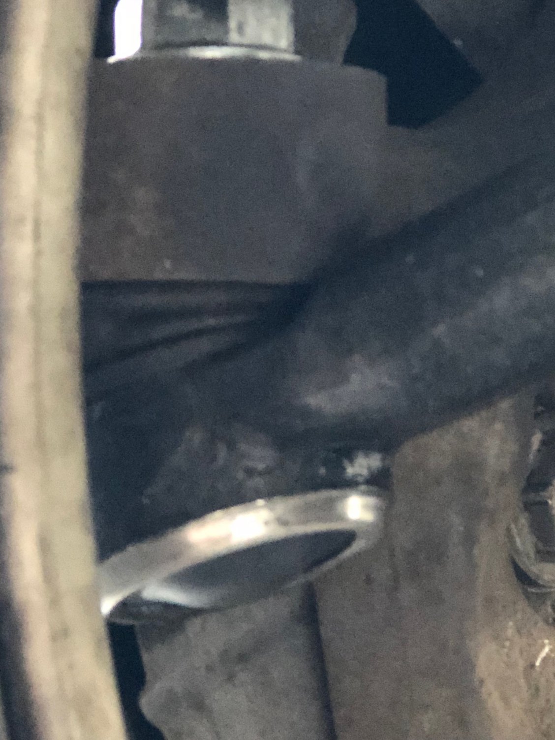

Ok, I’ll try posting some pictures. I checked my measurements just now and the drivers side is down 3/4” from the passengers side now, so it might be settling, but I’m still concerned.

Those look to be some pretty severe angles, on the tie-rod ends, on the upper control arms, etc. if I'm seeing things correctly and the weight is on the front end. Something isn't right.
Thats as it sits in my driveway. I’ve been driving it. 🤔
