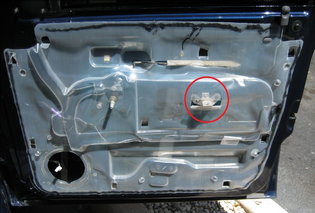

I've never heard of this either. The screw at the base of the interior pull handle on the plastic panel bolts directly into a metal bracket that is attached to the door shell, so there's nothing "plastic" to break on the back side of the panel from pulling too hard on the handle:
