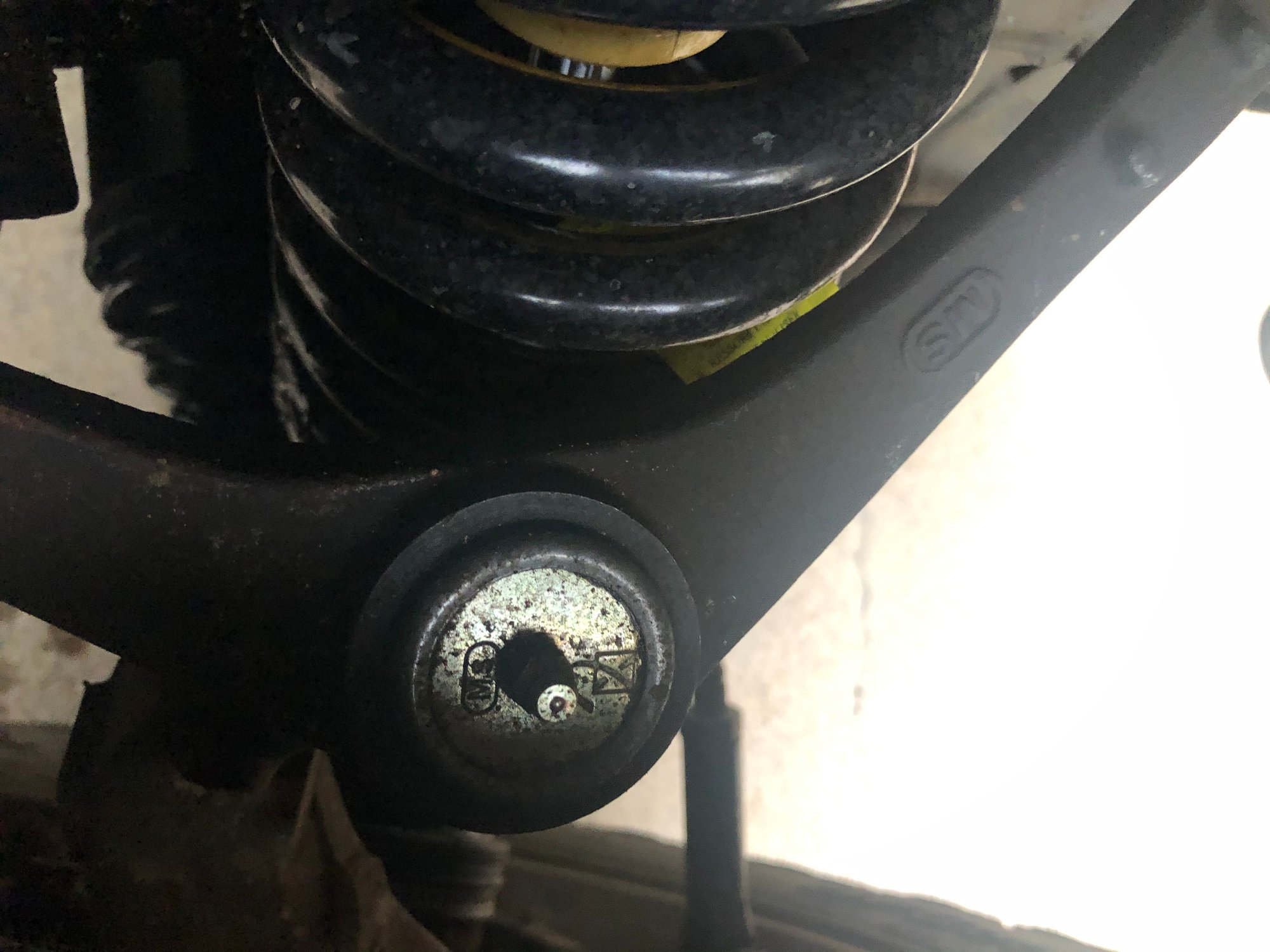

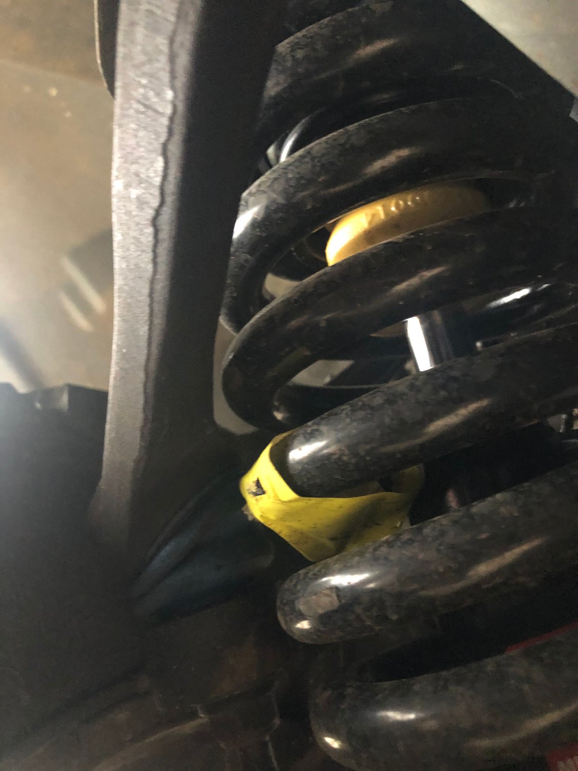

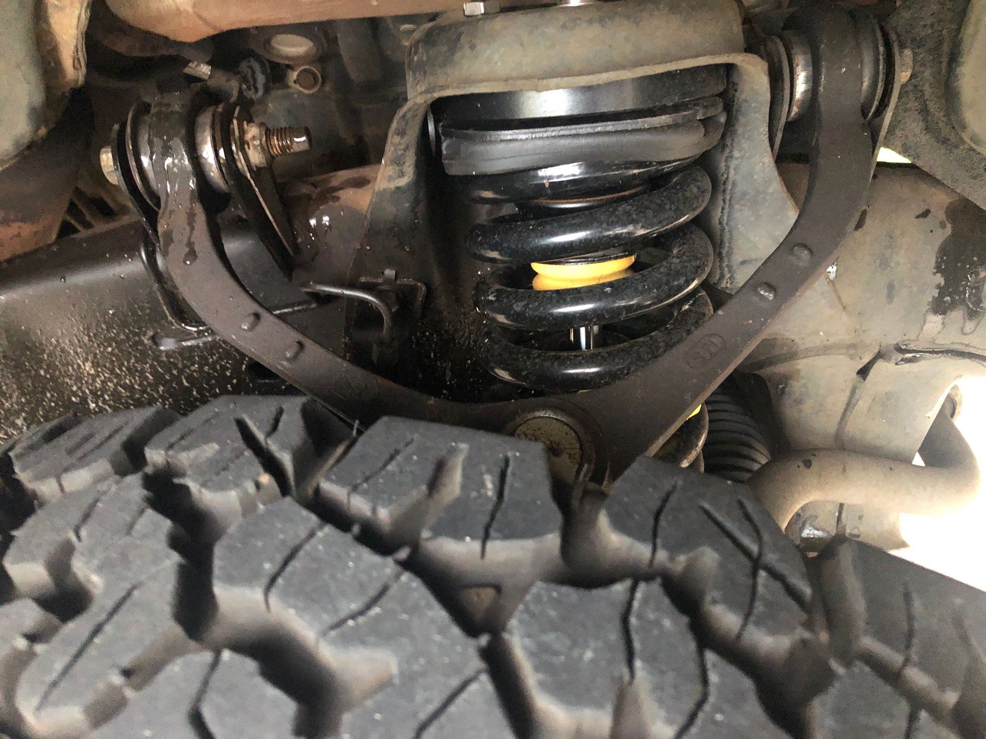

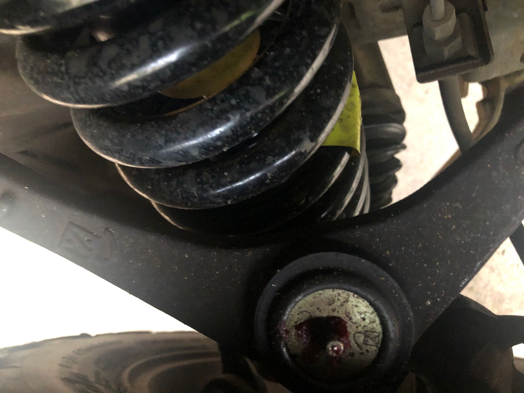

Hey All,
Been looking on the forums and couldn’t find my exact issue. I have a 2006 dakota 4x4 with a 2.5” Supreme Suspension leveling kit installed in the front and 1.5” installed in the rear. However, in the front my upper control arms are only 1/8” away from my springs at rest and have been hitting. Of course, Supreme Suspensions doesn’t advertise this issue. I can’t find after market extended upper control arms for our trucks. Any suggestions on what to do? Please help!

with anything that you modify there are drawbacks. Forcing the spring to push down on the lower control arm will make the upper control arm swing lower then normal, that is how these kits work. Unfortunately, unless you custom fab your own upper and lower control arms you will have this.
A 2" kit would not be as bad but still there. a 3" kit would be worse.
The lower control arm alignment could be closer inboard on your truck causing the spring to be closer to the upper compared to others, but changing this will cause driving issues. Have you had an alignment after the kit was installed?
You might have no choice but to keep it this way, or replace with a smaller leveling kit.
