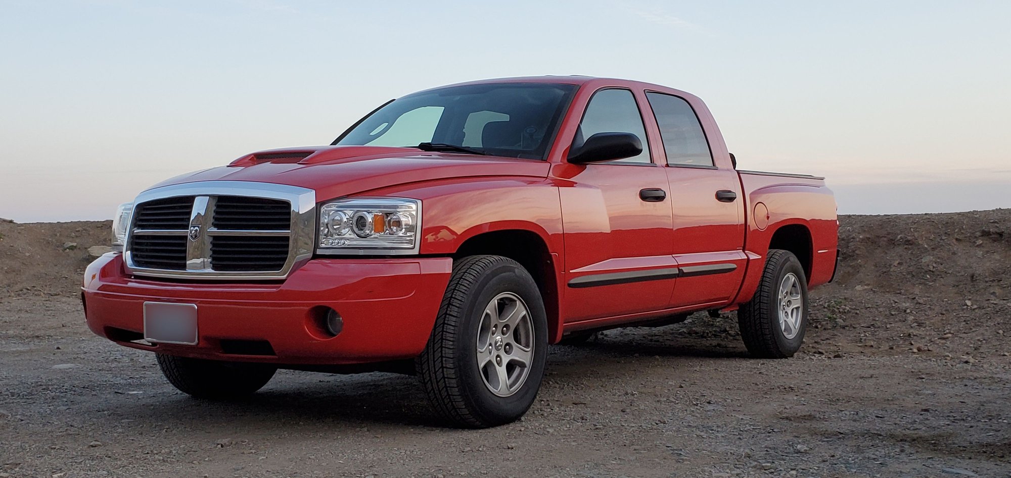

Thanks for the in depth reply! It's really appreciated. It's an 06 crew cab. It's the one attached in this post. I've been loving it but want to modify it further. I was wondering about the seats/covers cause I was curious if anyone had a good experience with a relatively cheap cover that color matched at least somewhat. Thanks again for the help!

Nice looking truck. Looks like you've even managed to avoid the rusting fenders at the wheel wells.
