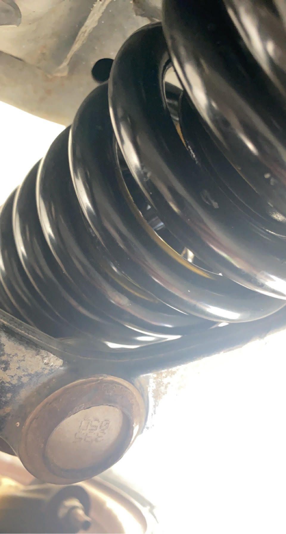

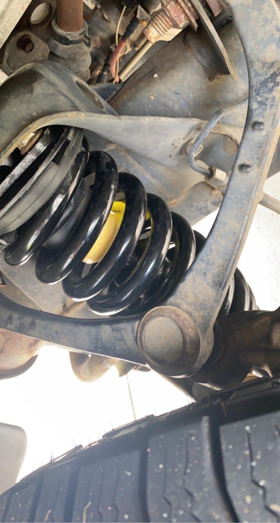

I just put a 2.5 inch lift on my 2006 dakota. My upper control arms give my springs no room. They hit my springs whenever I hit any sort of bump. I need some help finding some upper control arms that give my spring more clearance. Or just a spindle. I've searched and searched yet still nothing good. The lift kit I put on it is the 2.5 lift on rough country.

Have you contacted Rough Country? They made the kit, so they're the ones to ask. If the kit needed extra parts to work they should make it clear on their website. The Dakota is narrower than the Ram Pickup and the A-arms are much shorter than the Ram A-arms.
