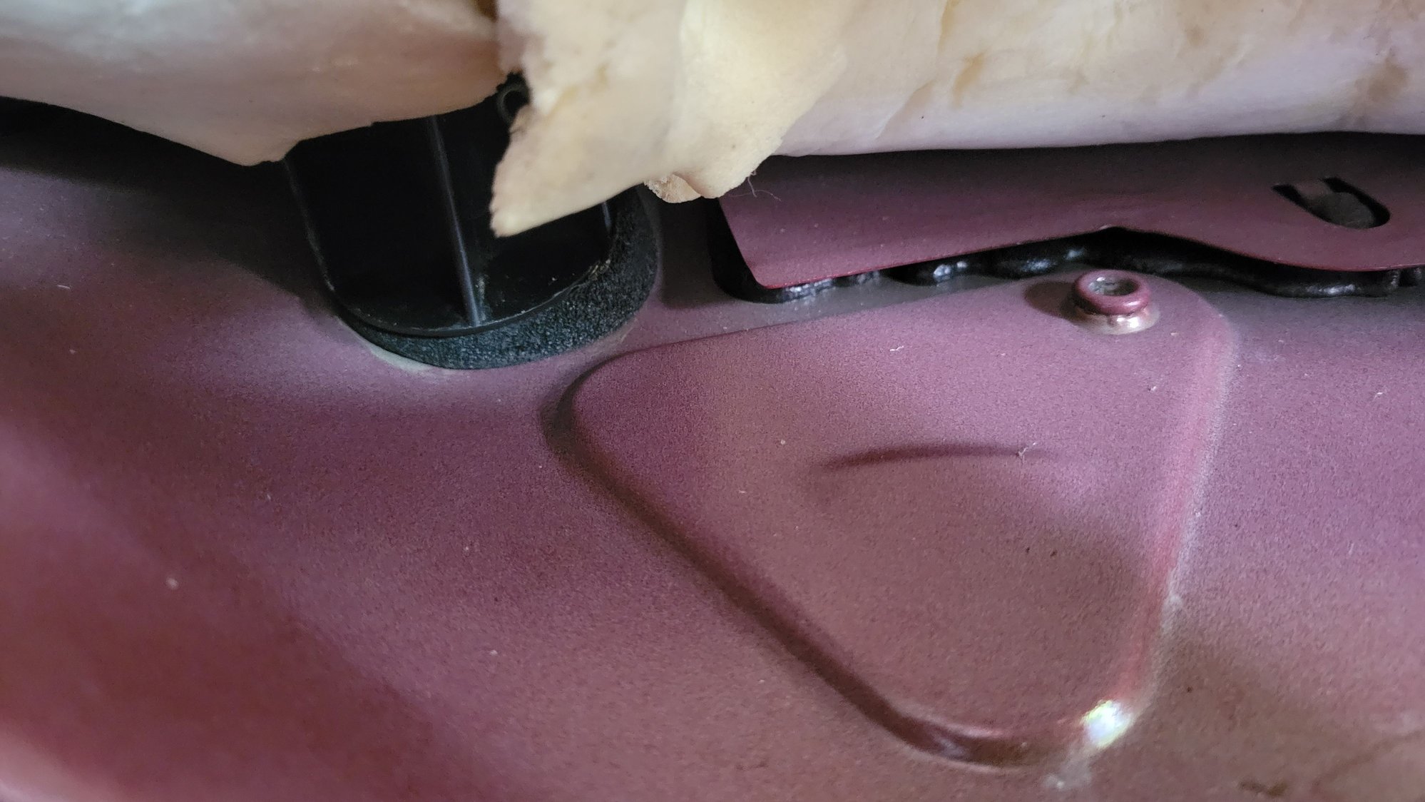

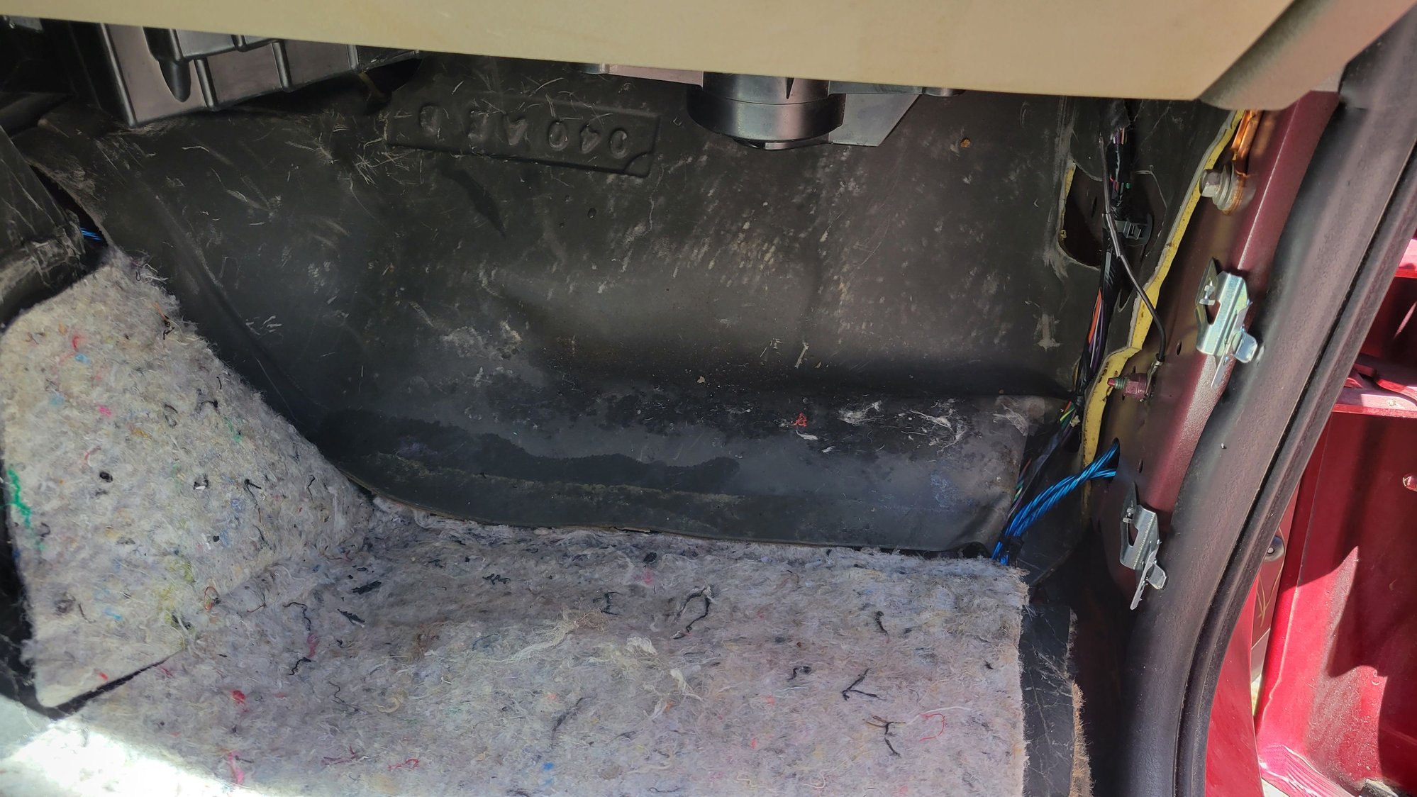

Passenger floorboard with carpet pulled back.
Where drain passes through firewall.
Lift rubberized insulation for better access to drain. Gasket is visible between drain and firewall. Coat the foam gasket and joints between drain and firewall liberally with RTV.

Originally Posted by rodslinger
I've left the carpet pulled back overnight to help dry out and let the RTV cure. This may require a second second dose to fully seal.
I'm taking a road trip to NC today and will see what happens.
Thank you! The pictures helped a lot. I found the same spot in my truck and it's drenched. Definitely has to be where the water is coming from. How do you suppose would be the best way to get RTV around to the top of the seal?
