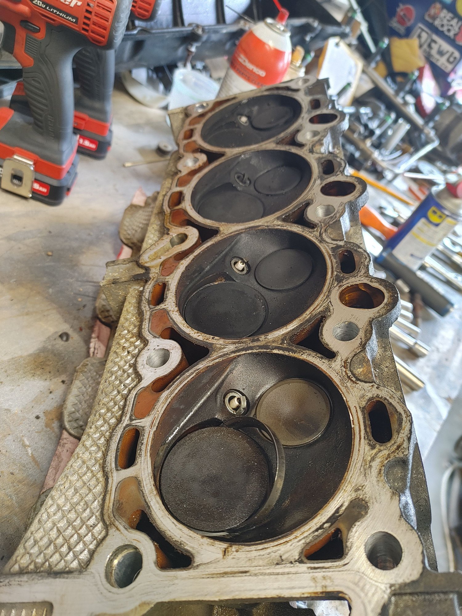

Yep, that'll do it. #2 fully popped out and #8 in the back is unseated slightly. No obvious head gasket problems but who knows. New upgraded heads from Odessa ordered. Fun times. For what it's worth, this will cause a P0068 code on a 4.7.

I appreciate it. I ended up just ordering some reman's from Odessa in Clearwater. They have some decent reviews and have been doing this for a while. They also rebuild these with tighter valve seat pressings so they won't fall out again. And they carry a 5yr warranty if they do. In any case, now I just have to wait for them to be delivered.
