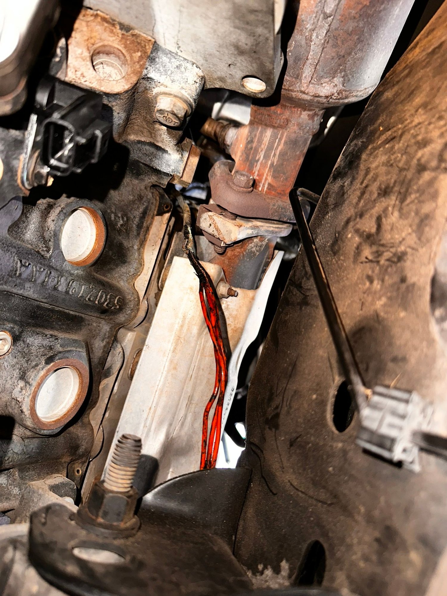

Here is what I found.
The wiring from the crank shaft sensor is shorted out.
Next question is where does the wiring exit up top of the engine compartment?
I've tried to push the wiring up from the bottom but it won't go anywhere.
Thanks.
