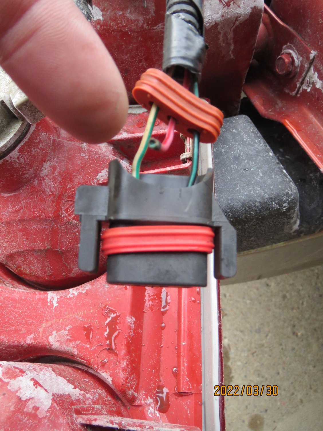

Had an issue myself last summer with my 2008.
As I recall, there is a wiring connector just before the taillight itself. You can see it if you pull off the tail light. The connector corroded. Only had some lights on that side of the tail.
Couldn't find the replacement connector itself. Landed buying an aftermarket trailer harness for the Dakota and utilized the connector off of that.
Took some pics at the time ....
