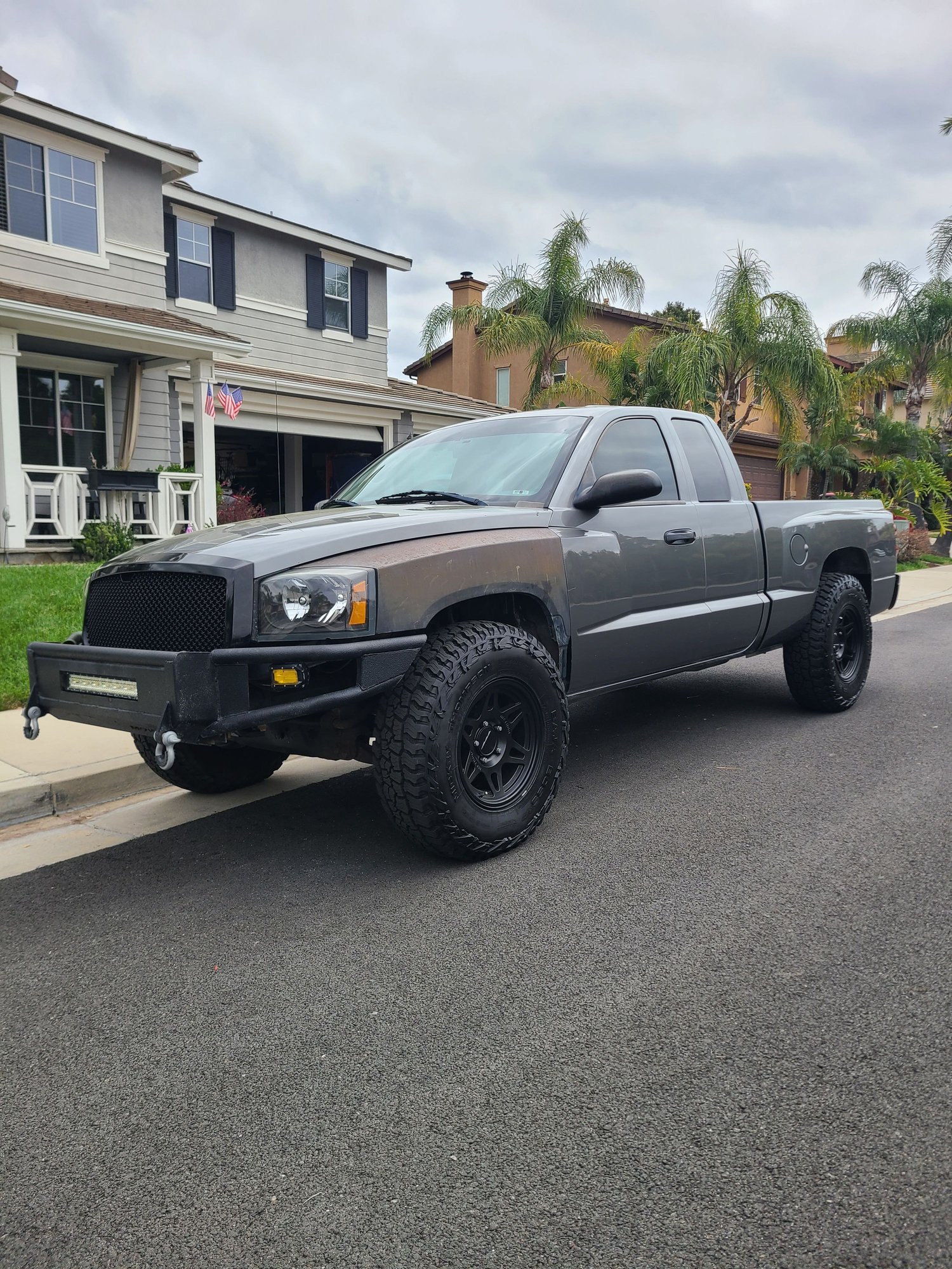

Rim size (diameter/width/offset): 17x8.5 0mm
Rim manufacturer: Method 706s bead grips
Tire size: 255/85r17...35's
Tire manufacturer: Mickey ThompsonLifted
1/2-inch spacer lift front.
Rubbing (yes/no): No frame rub...But rubs the outer firewall and rear arches...
I had to cut out some of the firewalls and make "new" arches on my rear bedsides to make the 35s fit with basically no lift. Also had to cut out the mud flap on the front fenders. I didn't want to limit travel with the crappy lift spacers so I did this instead... Let me know any questions...if people even come on this forum anymore.

Looks phenomenal, very happy to see it. Also is that a move bumper?
yes its an embark move bumper...I plan on redesigredesigning it soon so it doesn't have so much of a 'chin'.

Ya seems to stick far forward. I was going to get a precision with cross tubes over the grille. Because I live in deer country.
I'd love some photos of your work? I'd like to upgrade to 35s but hate the concept of body lifting. An your finished product is what I'd love mine to look like.
