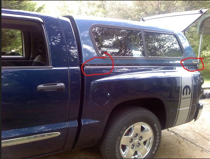

2nd gen's will fit as well. Seems to be more of a selection than ones specifically for 3rd gens. Only difference is the top rail is tapered on 3rd gens. The topper for the 2nd gens is square so it hangs off a bit at the back and in a bit at the front. Inside the bed it's perfect. For some reason, Dodge decided to add the taper to the outside top rails on the 3rd gens. I picked this one up for $100.
