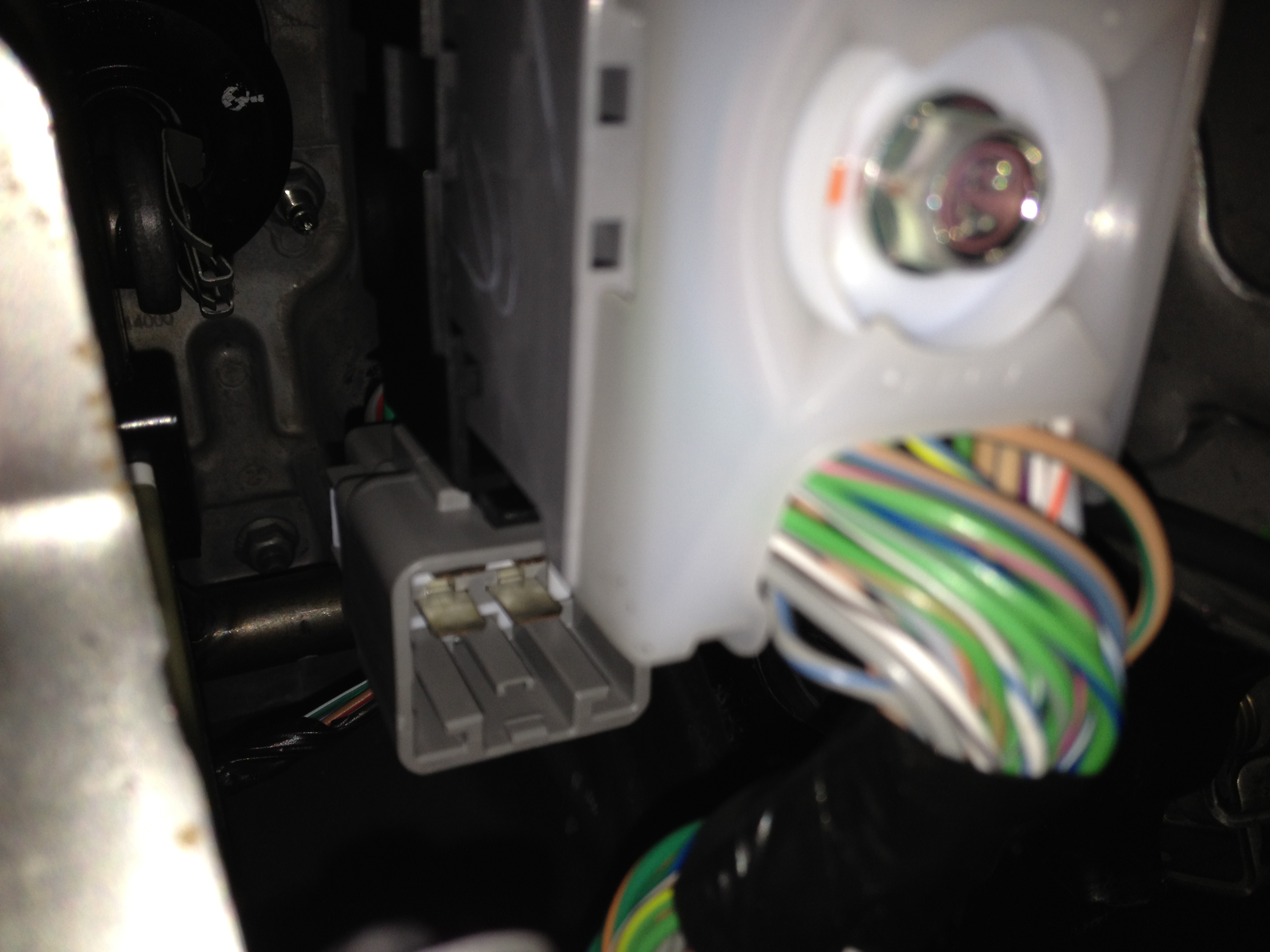

I just purchased the Tekonsha Prodigy P2 Brake Controller with the wiring harness for my Citadel (factory wired). Now I just need to find where to connect it to the Citadel. It was really easy to find it on my '98.
edit: I just found it, to the left of the OBDII connector and to the right of the emergency brake pedal.
