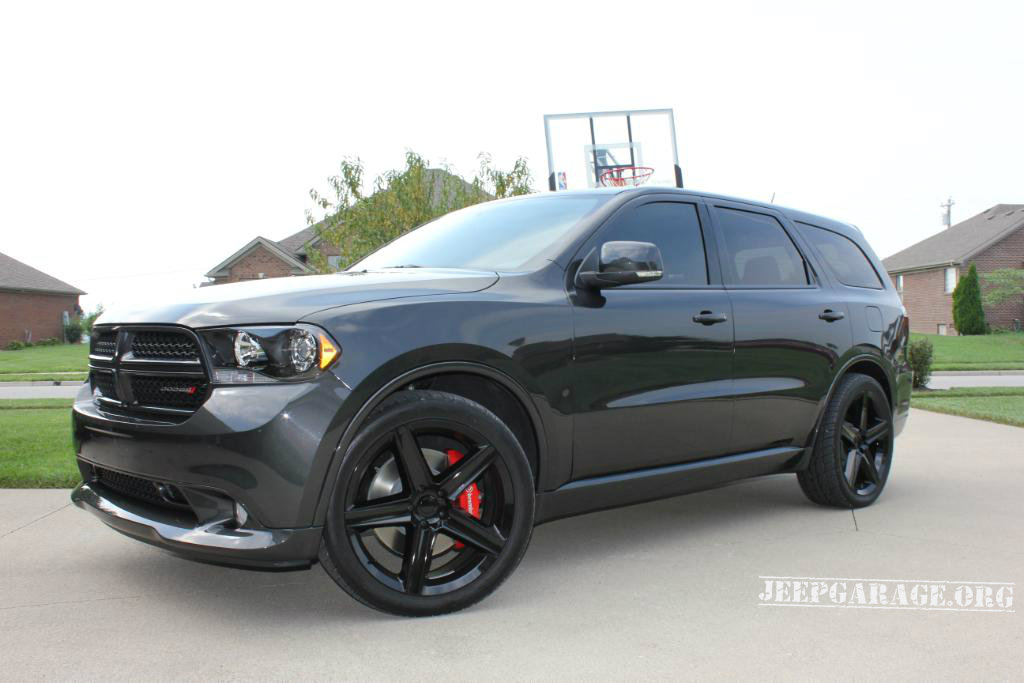

Talking SUCCESS!!! 2012 Jeep SRT 6 pot Brembos on a 2011+ Durango WD!
heres the pics with my Dslr. I only used the 2012 6 piston Jeep SRT brembo calipers and rotors. Everything else is good to go!

Hot!!!!! Can't wait to see it with the rears! You're the first to do this right?!
I have to say though, now that the brakes are on, I think your other wheels will look better! Or maybe if you paint these wheels grey!

Damn, that looks nice! I have got to get Caliper Covers for mine..... at least the covers!

bad news on the Savinis....they didnt work. I will need about a 1/4" spacer. Im not gonna put spacers on my wife and family vehicle. I just dont trust them.
The rears will go on as soon as the calipers get here. They are on national backorder till mid August or so. Should have them in the next couple weeks.

Looks great bro, glad to see it worked out!

Sucks! I've been running spacers on my G37 for 3 years. But I have the hubcentric ones. I also wouldn't trust the hubless spacers!

I have some install pics Ill post up in a bit...but this was very easy if you know how to bleed brakes. All I used was the jeep SRT8 2012 brembo calipers and 15" Jeep SRT8 rotors. The splash shield wasnt needed.

They look great! How do they work? Much better than the stock ones? How much did they cost if you don't mind me asking? I noticed you didn't go with drilled and slotted rotors.
