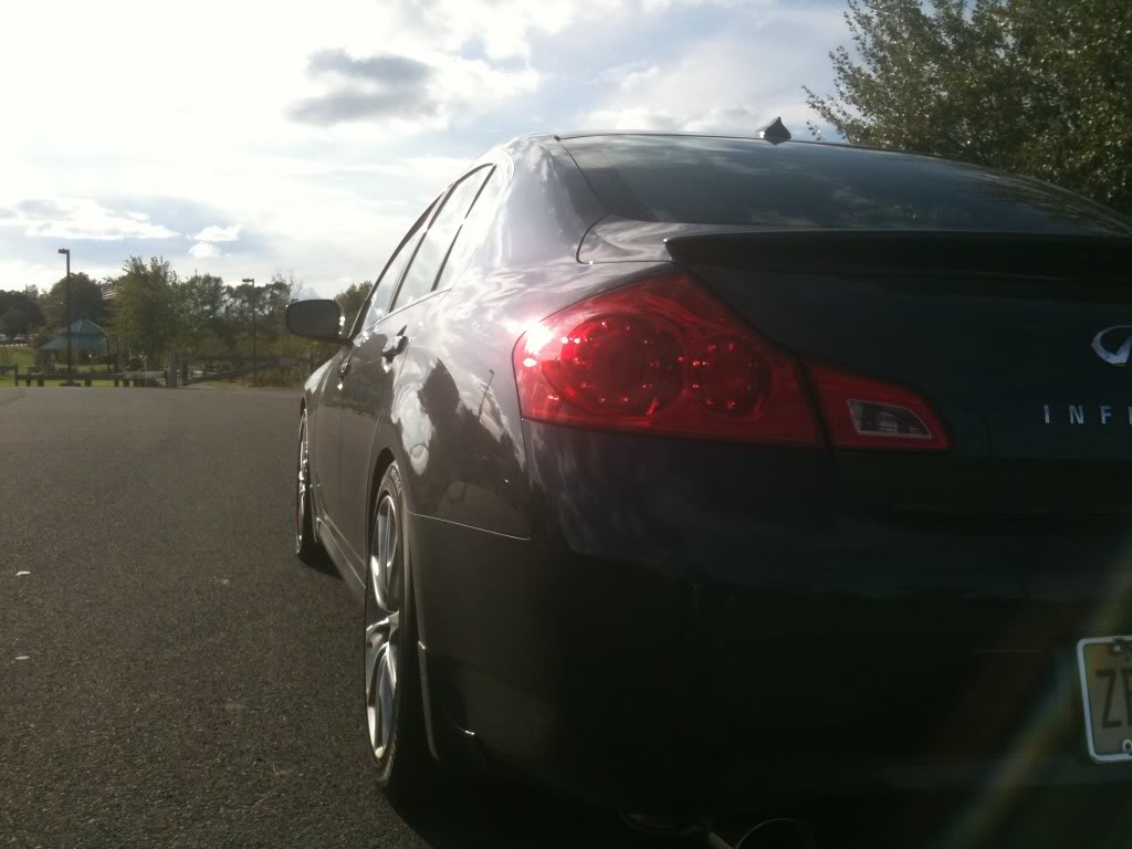

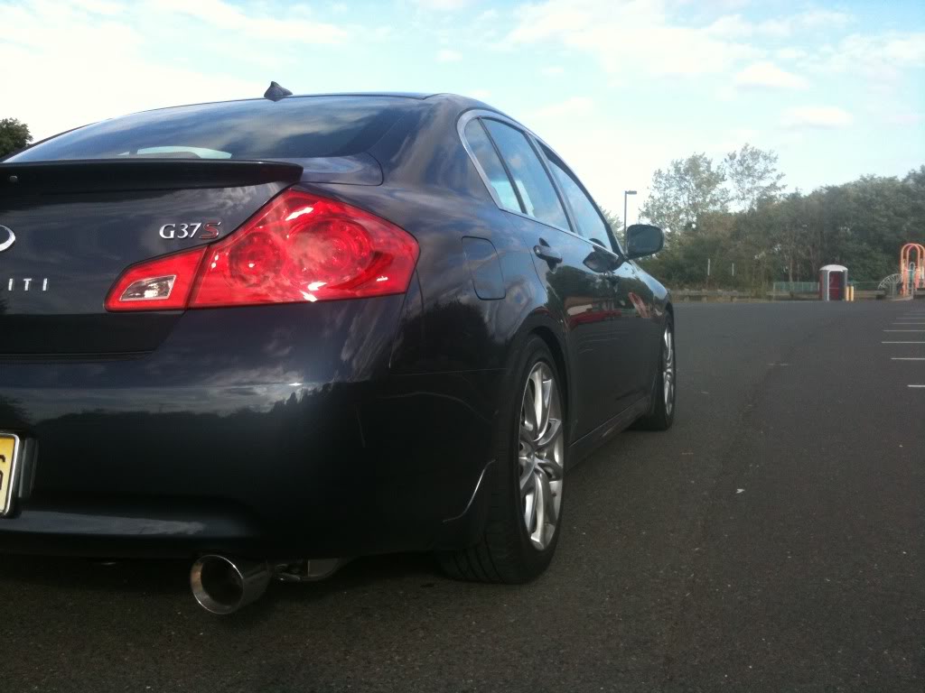

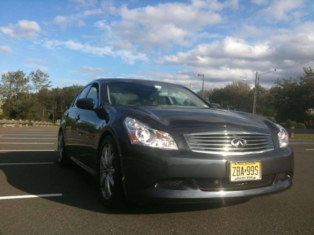

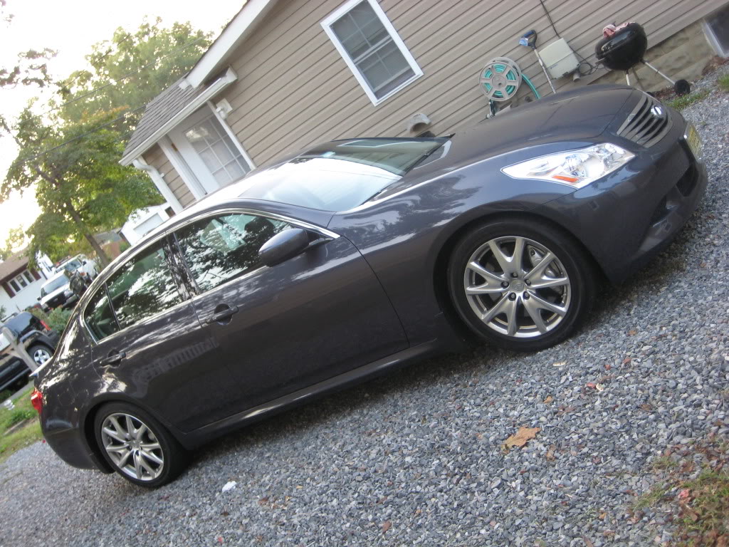

Yup! Did this on my G37. Looks much better.
Before:

After:

Much better... what kind of exhaust you have on there bro?

Tanabe Medalion! Just an axle back though! All the cat-backs I looked into sound too loud! These sound just right!
