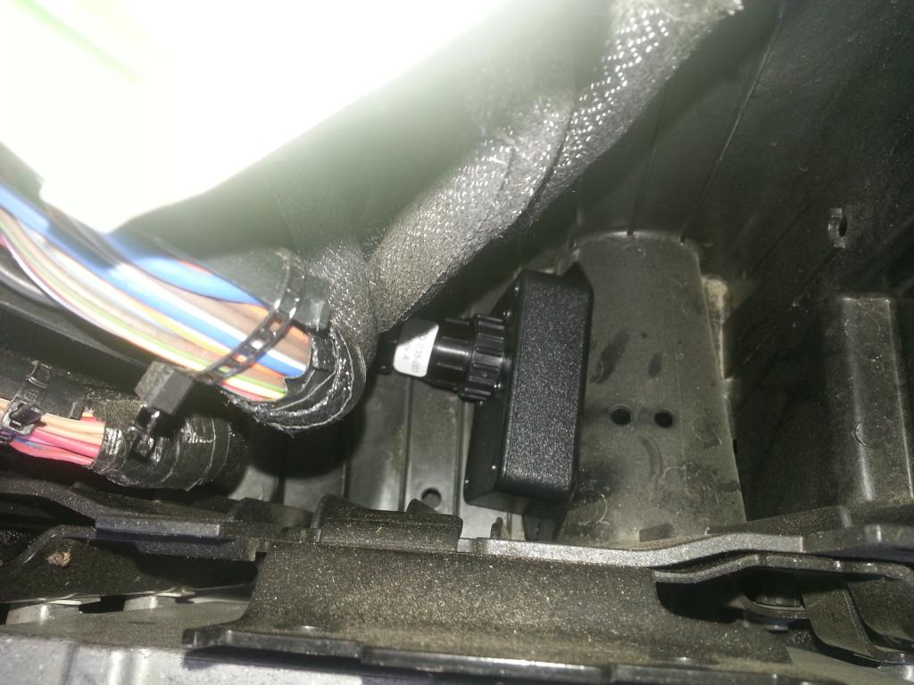

Last night I installed the HyperTech Interceptor and its really a plug and go setup. It took me under 15 minutes to do whole install. Since HyperTech already has an install video in below link I will go over differances for the Durango. Also, I disconnected battery during install to reduce chance of any electrical shock or shorting. This will also help after install so engine will remap itself with tuner to ensure maxium gains with tuner.
http://www.hypertech.com/products-interceptor.aspx
For the placement of the controller you must lift fuse box up which is held down by 4 clips. Its easiest if you do two on right then two on left. I layed mine down against hump with wires exiting to the left under all the current wires.

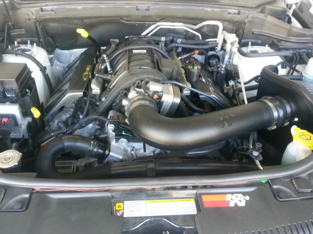

I started with the intake. If you have an aftermarket wire extension like the K&N intake you will no longer need it can connect as seen here.
For the MAP sensor I found that after releasing red tap a simple poke of a screwdriver will release stock plug. You will put flathead in from left to right with little force needed.

Here is my final install pictures. And I and very happy with the unit. Vehicle seems a lot more responsive.
