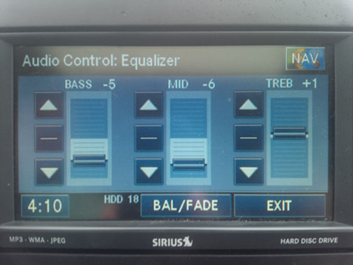

Nov 27, 2014 | 05:41 AM
Wash Man, good, I'm glad those levels helped out.
for higher volume levels I've been using these settings.
with another 2dB taken out of Bass (-5dB total) I've cleaned up 90% or so of the midbass distortion that I hear. the 2dB reduction in Treble (+1dB total) brings the highs back down a little.
higher frequencies in the Treble range can cause ear fatigue and actually be a little uncomfortable. that can be more pronounced as people age. (something you have to factor in for church sound levels when you're running contemporary worship).
I've been running my Volume level at around 21-25 when I'm driving by myself and the lower Treble (+1dB) so far seems to brighten the sound without causing me to get tired of hearing it.
again, these EQ levels mean the Volume has to be pushed higher to get the detail and presence that you would have with much lower Volume at a flatter EQ. but the result is MUCH cleaner and more balanced sound (at least in my system) and the HU has plenty of headroom.

you might try lowering the Treble to +1. I've been running these setting (below) that I mentioned earlier and I find I like these better at higher volumes. my ears tell me the treble is too bright with the original settings at higher volumes.
it would be interesting to have that RTA app and see what it says.
