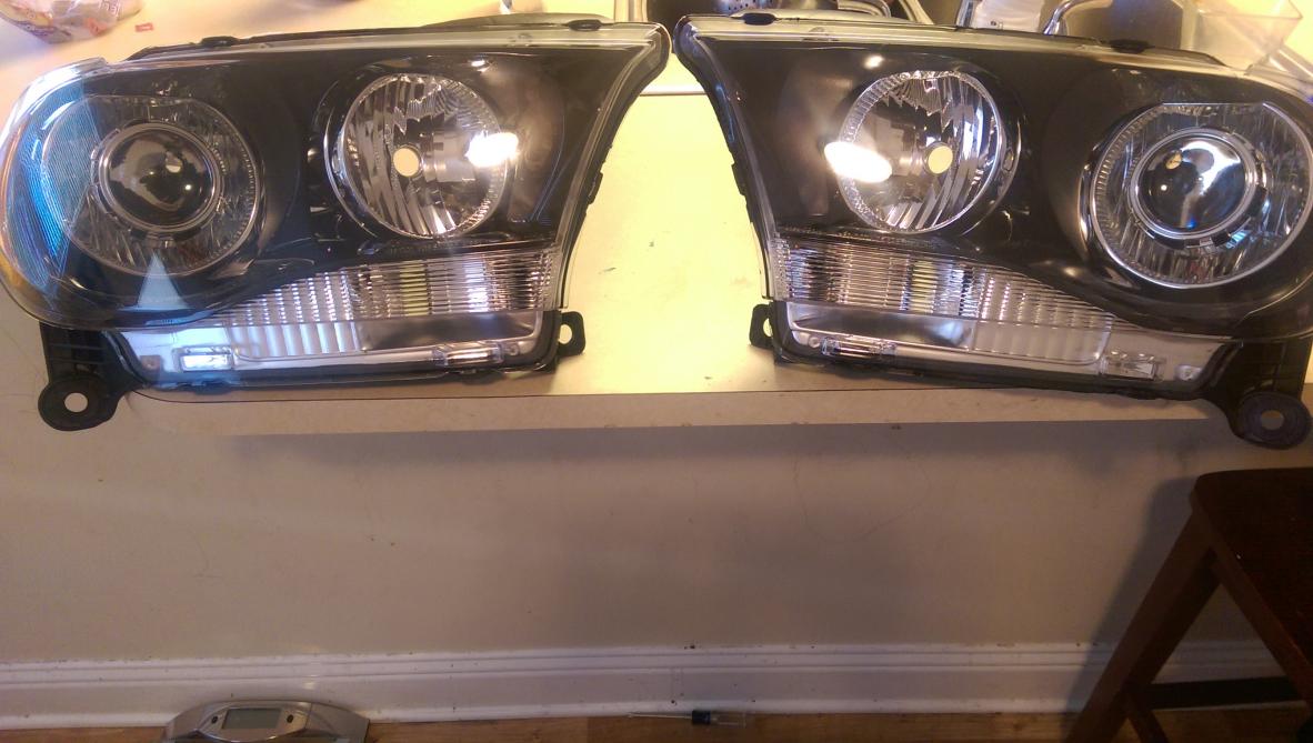

Hey, I purchased mini h1 projectors with the shroud for retro kits and halogen headlights black in color. That cost about 200 from ebay, all new. I did the install over the weekend and it's didn't take long at all.
Bake the headlights at 225-270 degrees for 7 minutes and they came apart easily. The shield on the low beam I just bent it off, then took my drill with an unibit to make the projector fit into the bulb holder. At the point it's easy to do with the supplied mounting options.
I am still waiting on the ballast and bulb to show up. The best part of this is the stock headlights are still on the car. Before I install it I'll be sure to record the beam levels.

Thanks, I think projectors provide the best light output compared to a non projector setup.
