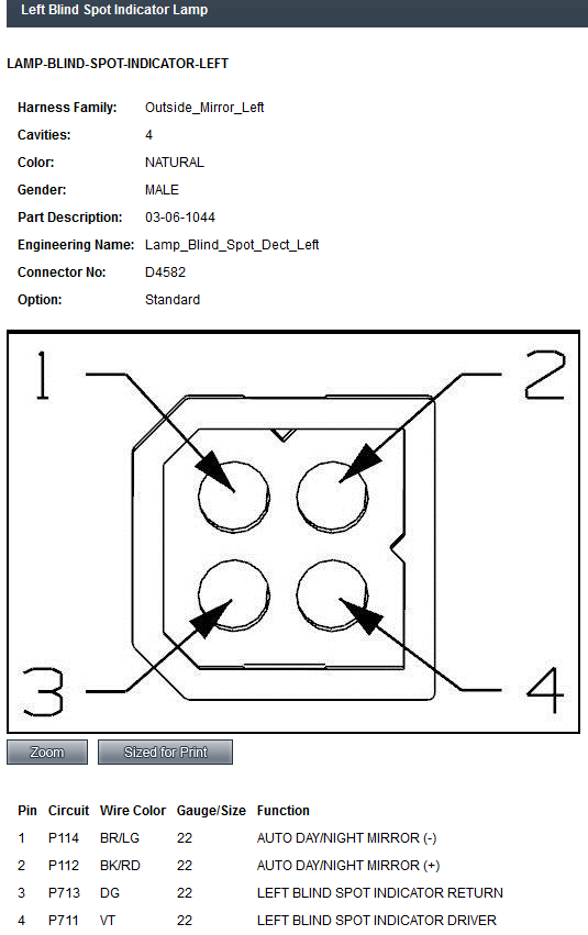

Before taking the mirror glass off, I'd recommend finding the connector at the base of the mirror and checking for voltage across pins 3 and 4 of the connector for the LED. Anywhere from 1.2 to 12V (depending on where the currently limiting takes place) is probably indicative of a good voltage for the LED.
Name:  2016-01-02%2011_46_29-ALLDATAdiy.com%20-%202011%20Dodge%20or%20Ram%20Truck%20Durango%20.png
-Rod

Can you let me know whereabouts I would find that connector?
Is it behind the small access cover on the underside of the mirror, nearest to the car door?
Thanks

on most cars you will have to take the inside door panel off to access the mirror power plug and mounting bolts. it should be in line with there the mirror mounts to the car, just on the inside of the door.
