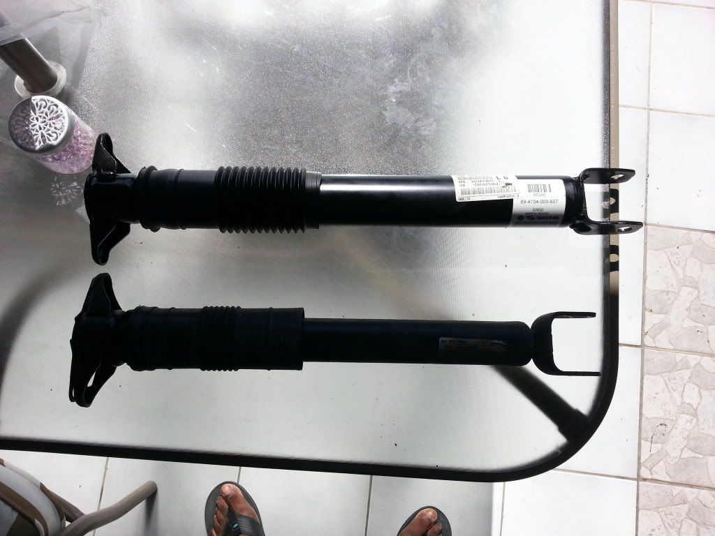

Here is a picture comparing the standard rear shocks (bottom) to the self leveling nivomat shocks (top.)

Im surprised they are that close in size . I had nivomats on a Grand Caravan with tow package once and those were massive, probably twice the size of a normal shock width wise .
