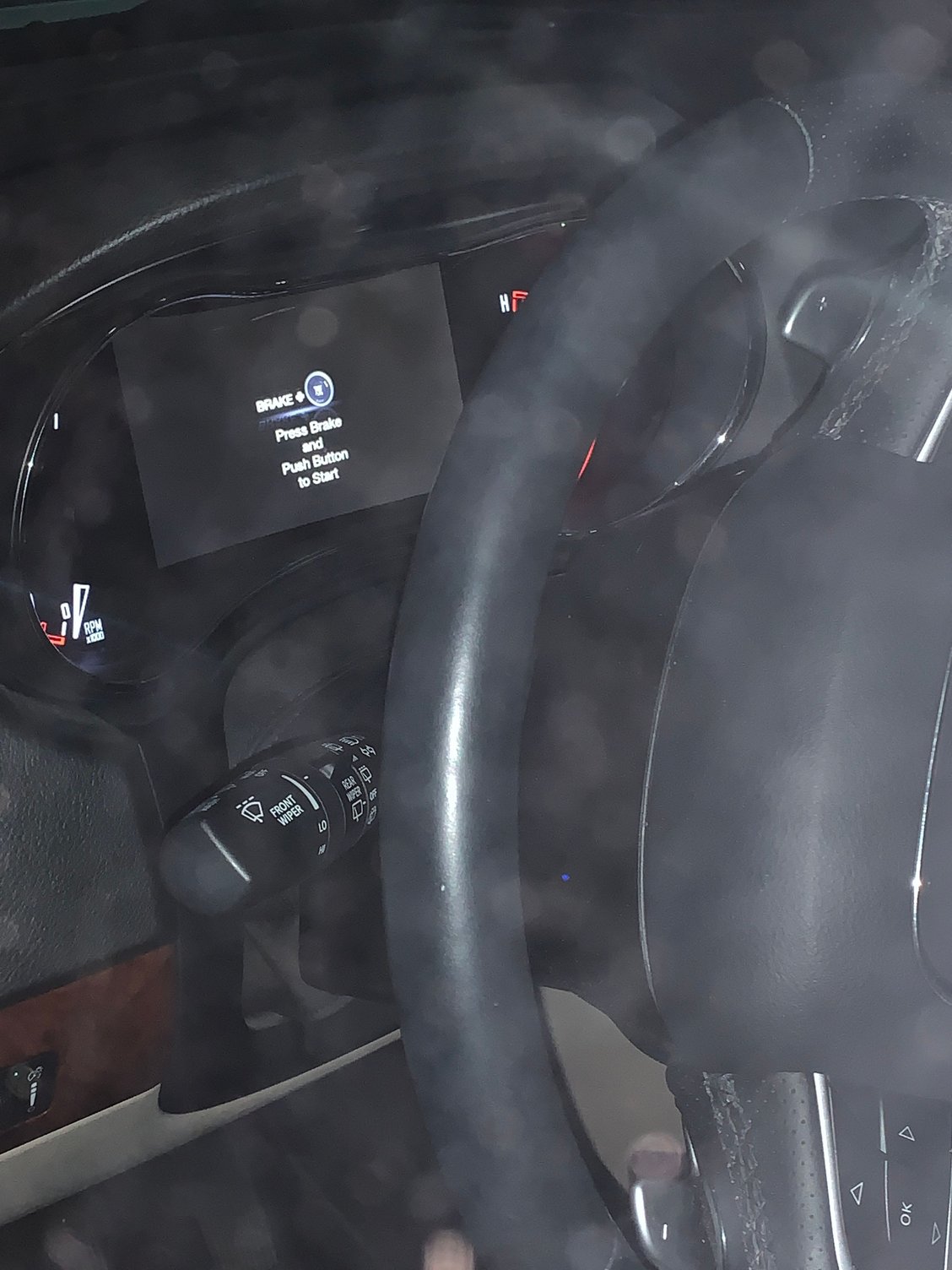

Dash message center lights up when you touch either door handle.
They key fobs are in the house probably 30 feet away from the vehicle. I have replaced both batteries in the key fobs. I noticed this issue one more when my daughter walked past the vehicle and her arm touched the outside of the door handle. Does anyone else’s Durango do this?

Mine does that...didint really think anything of it since the doors dont unlock unless you have the keyfob on you.

Its just ready for you to enter the vehicle. No issues.
