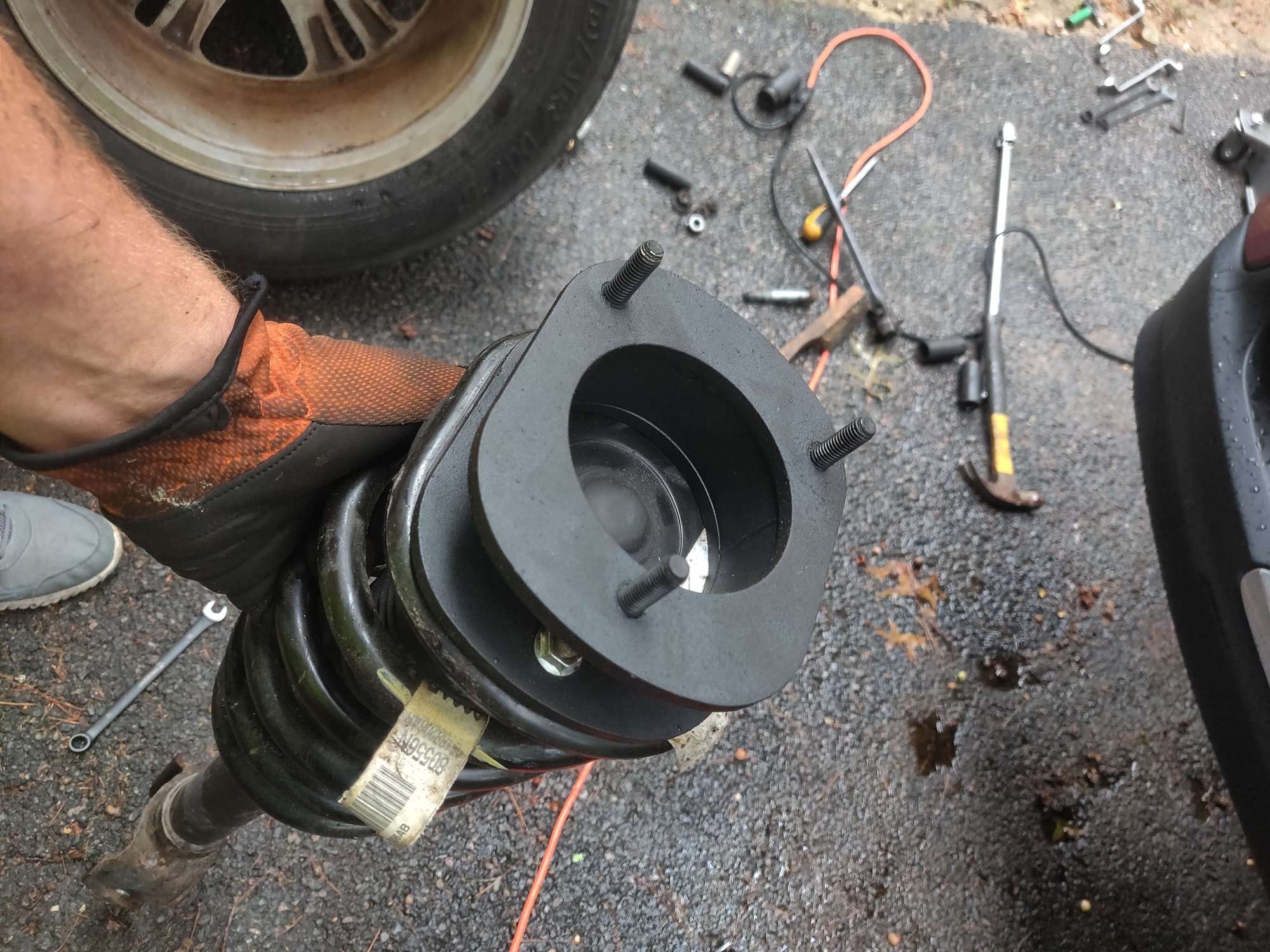

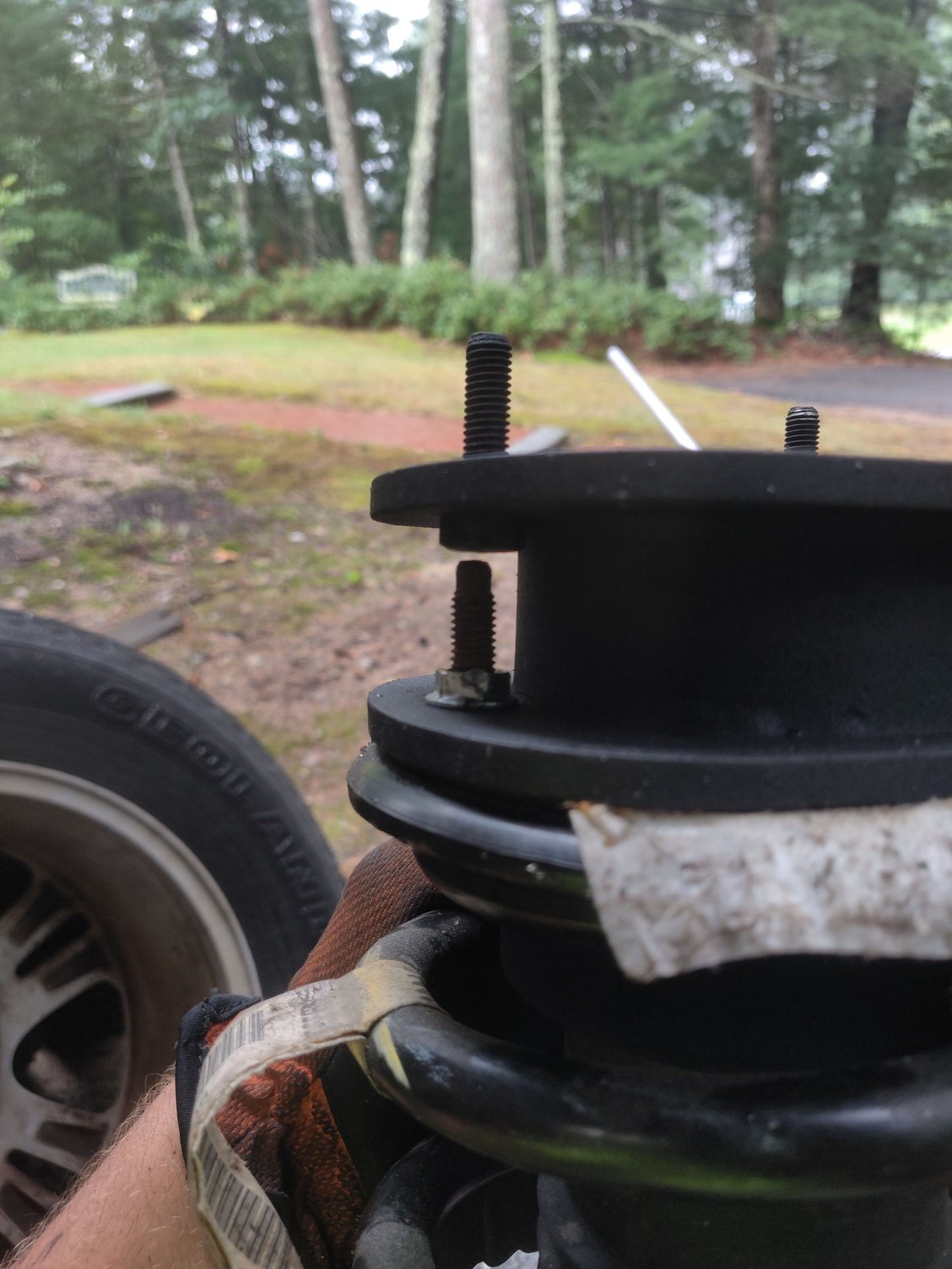

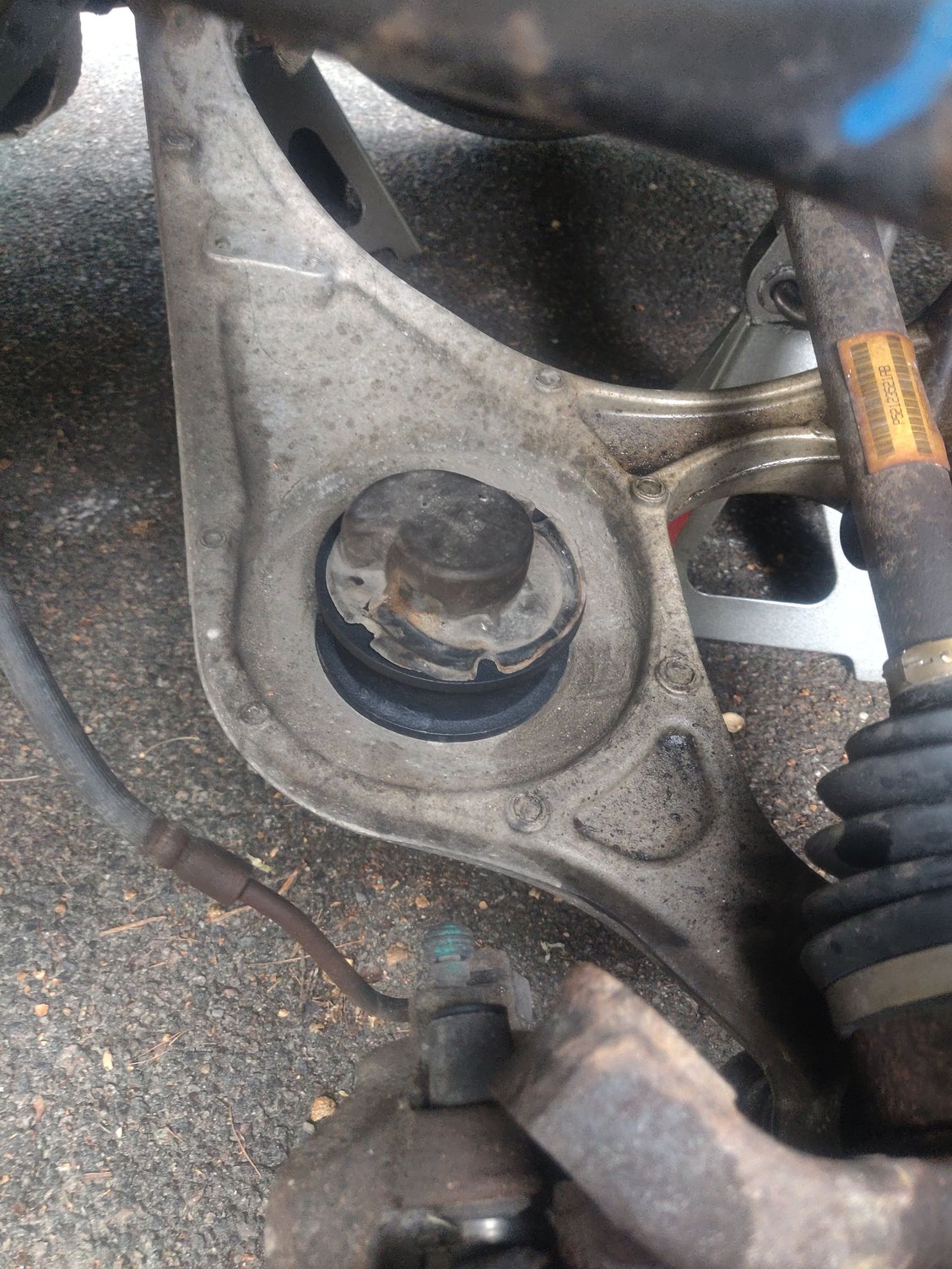

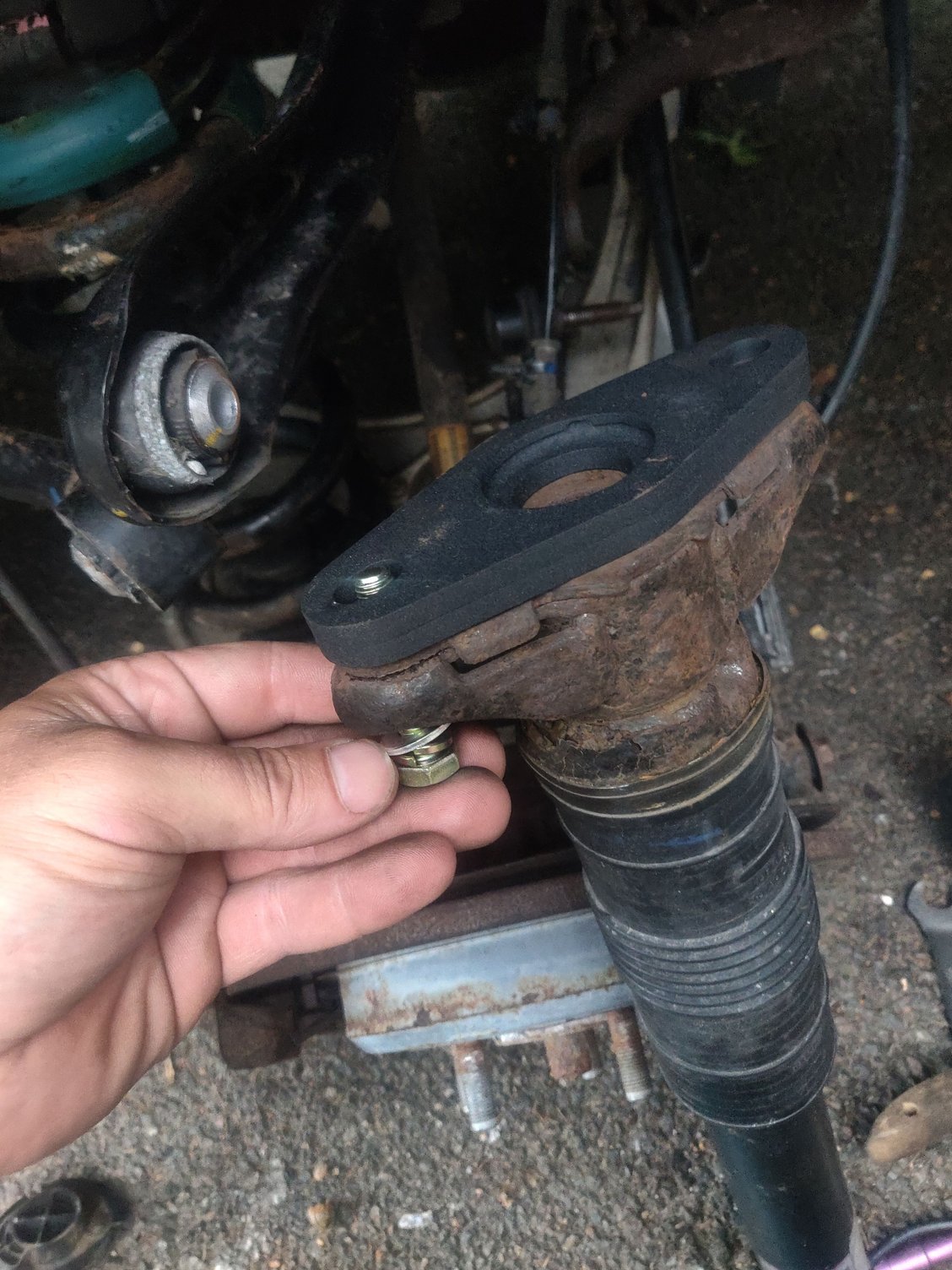

Finally found some time to work on this lift.
Sorry I didn't get more pictures if things as they went, but I was solo, and it rained most of the day.
Anyway 2.5"installed in the front. The rear will be another day.

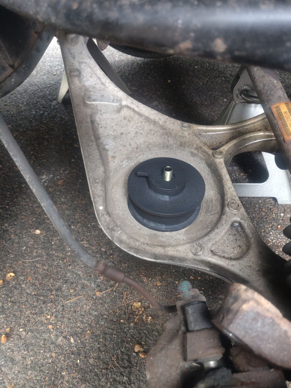

Got the rear 1.5" lift installed now. I love it.
1 piece of advice I'd give to any one installing this style lift, on their own, on a vehicle that's less than brand new. .
Buy 4 new stabilizer end links before starting!
This was by far the most frustrating part of this install. They fought me coming off. They fought me going on. I wire wheeled them. I pb blasted them. I have 4 new ones on the way because a couple of them were so tough that I couldn't tell if they were tight, or just done going any further. If I could of cut them off, and replaced them I would of saved a ton of time, energy, and frustration.

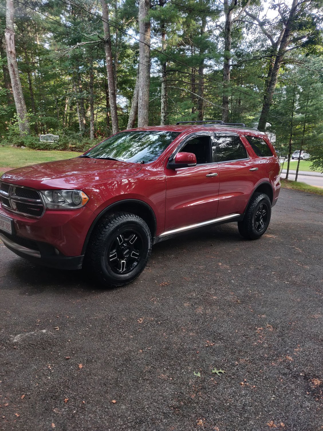

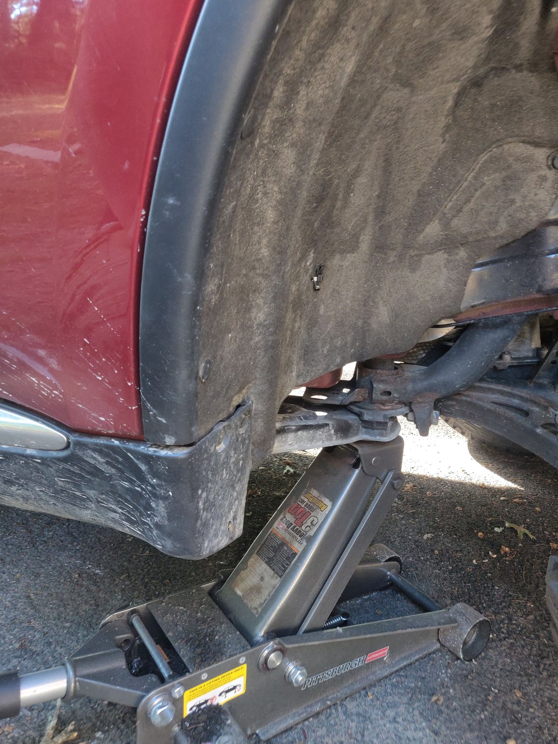

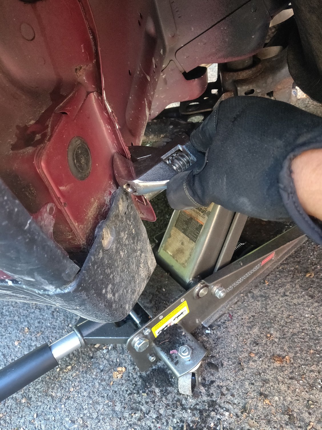

OK! HERE IT IS!
Lifted 2.5"front, 1.5" rear 265/70r18 +12 offset ultra armageddon wheels.
I got the tires at Walmart.com, the lift, wheels, and tpms sensors off eBay.
Because I had purchased the tires through Walmart I was able to have the service center mount, and balance the the tires, and sensors on the wheels for $48. (For all four)

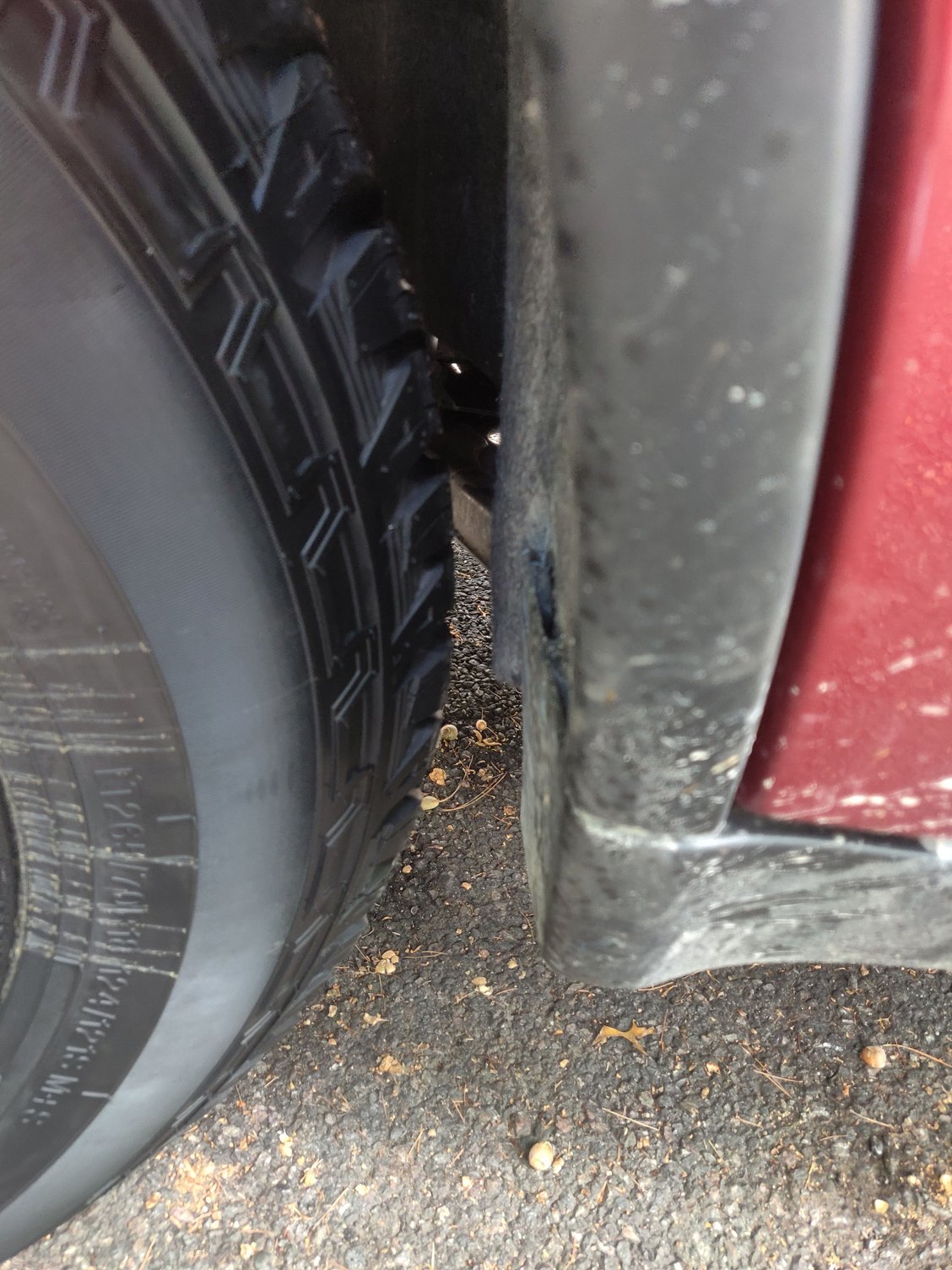

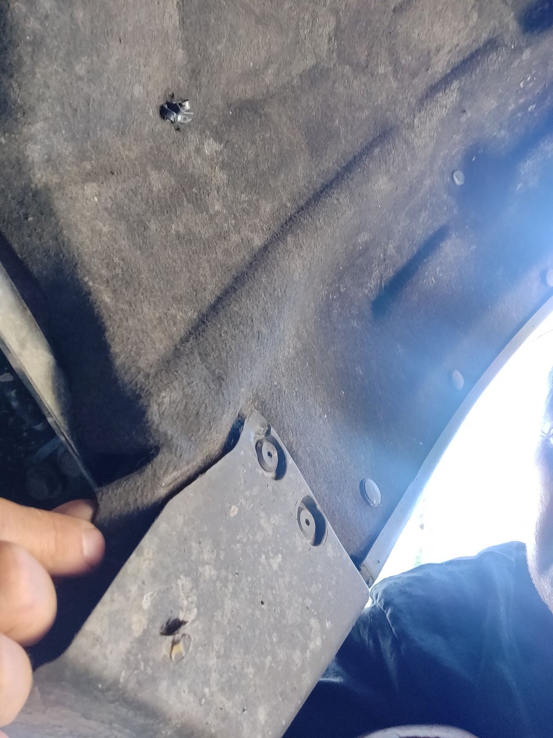

Then I installed them at home. Walmart (like most major tire shops) won't install anything outside of oem on any vehicle.
Besides I knew I'd have some rubbing to take care of.
Here's some pics of a standing seam I needed to "modify", and relief cuts I made in the felt wheel well liner that helped it lay a little flatter.
