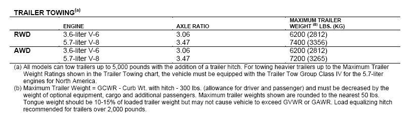

Hi,
looking for a straight answer…. I have a 2012 AWD Dodge Durango Citadel with 5.7 V8 Hemi, has the towing package as well. Need to know what weight it can tow as well as how “much/far” can/could I push it past that safety?

7,200 lbs is the max towing for the 2012 AWD 5.7L. Shouldn't exceed 80% when towing which is 5,760 lbs

Check the owners manual.
