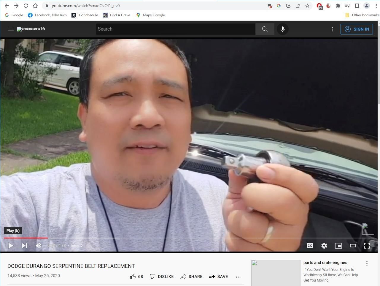

The first step is to watch a couple of youtube videos, to see how it's done. This guy made it look easy, so I decided to go for it.

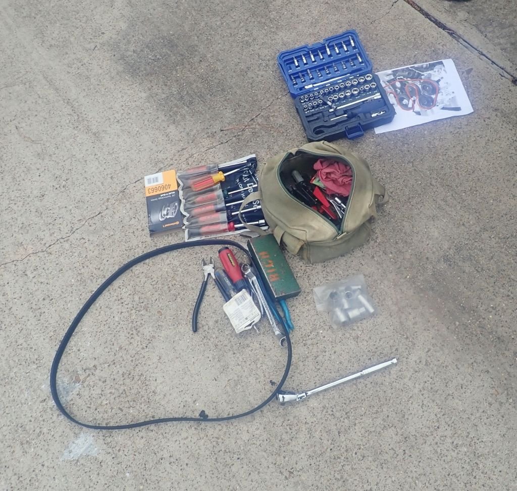

Tools. All I needed was a 5/16" socket and a 1/2" square lug socket.

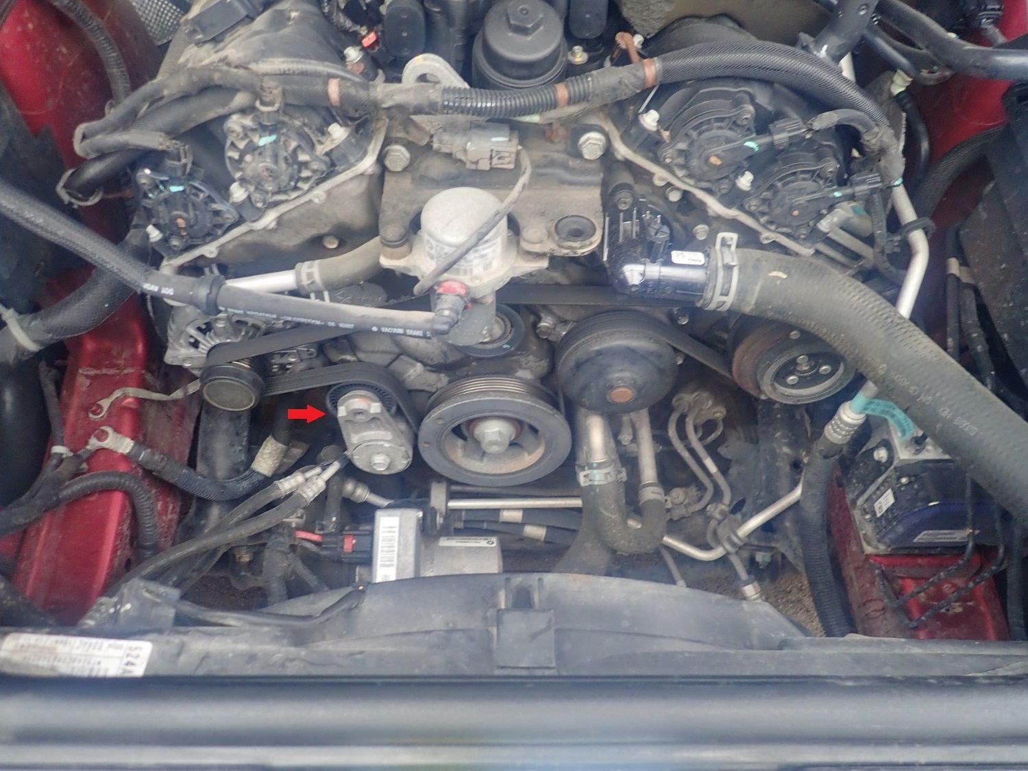

There she is. Remove the air cleaner stuff on top to gain access. Put the 1/2" lug in the belt tensioner on bottom left (red arrow). Pull to contract the coil spring inside and relieve the tension. Slip the old belt off. Slip the new belt on. Release the tensioner. Make sure the ridges in the belt are seated centered in the grooves in the pulleys. Easy peasy! Cross your fingers and start the engine to test it. Good to go!
