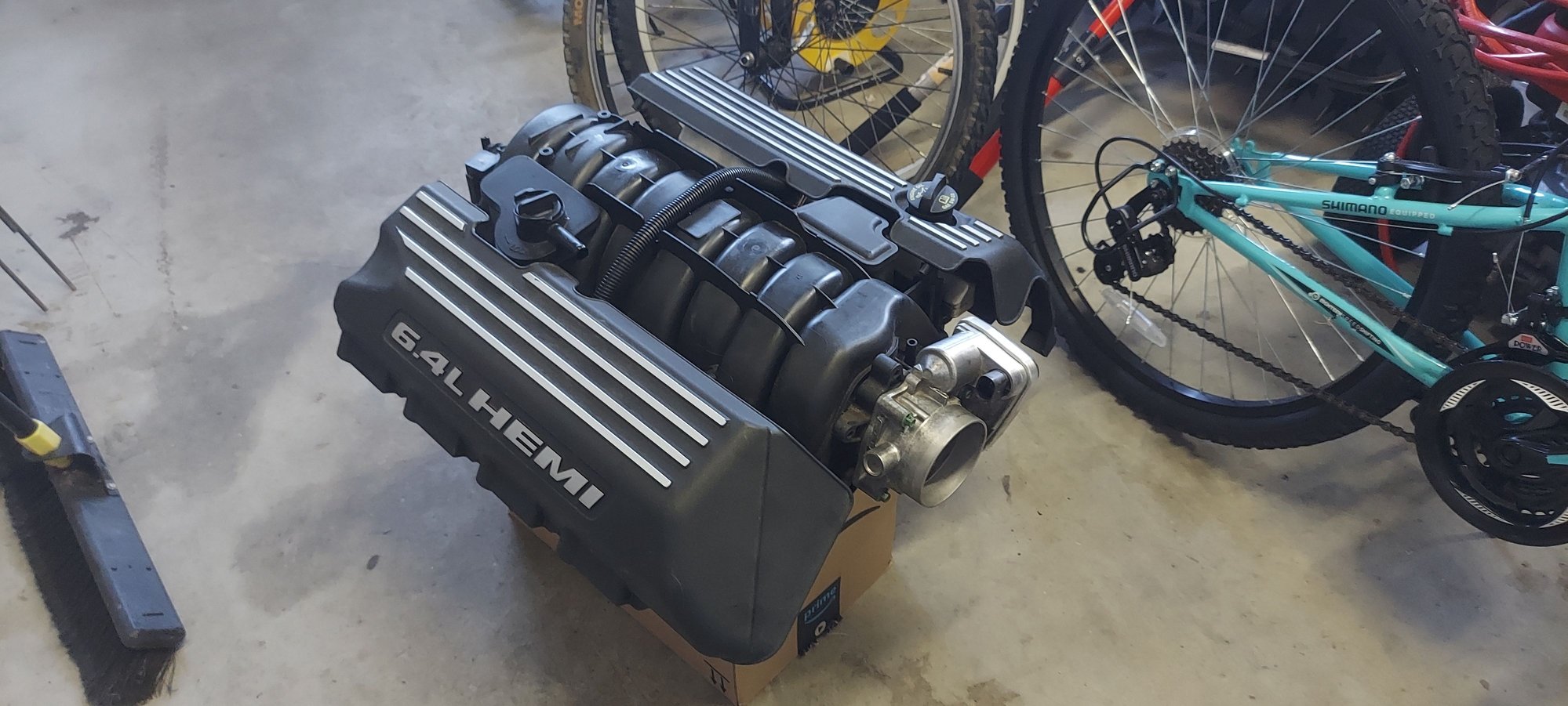

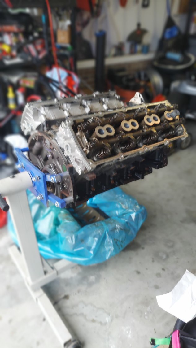

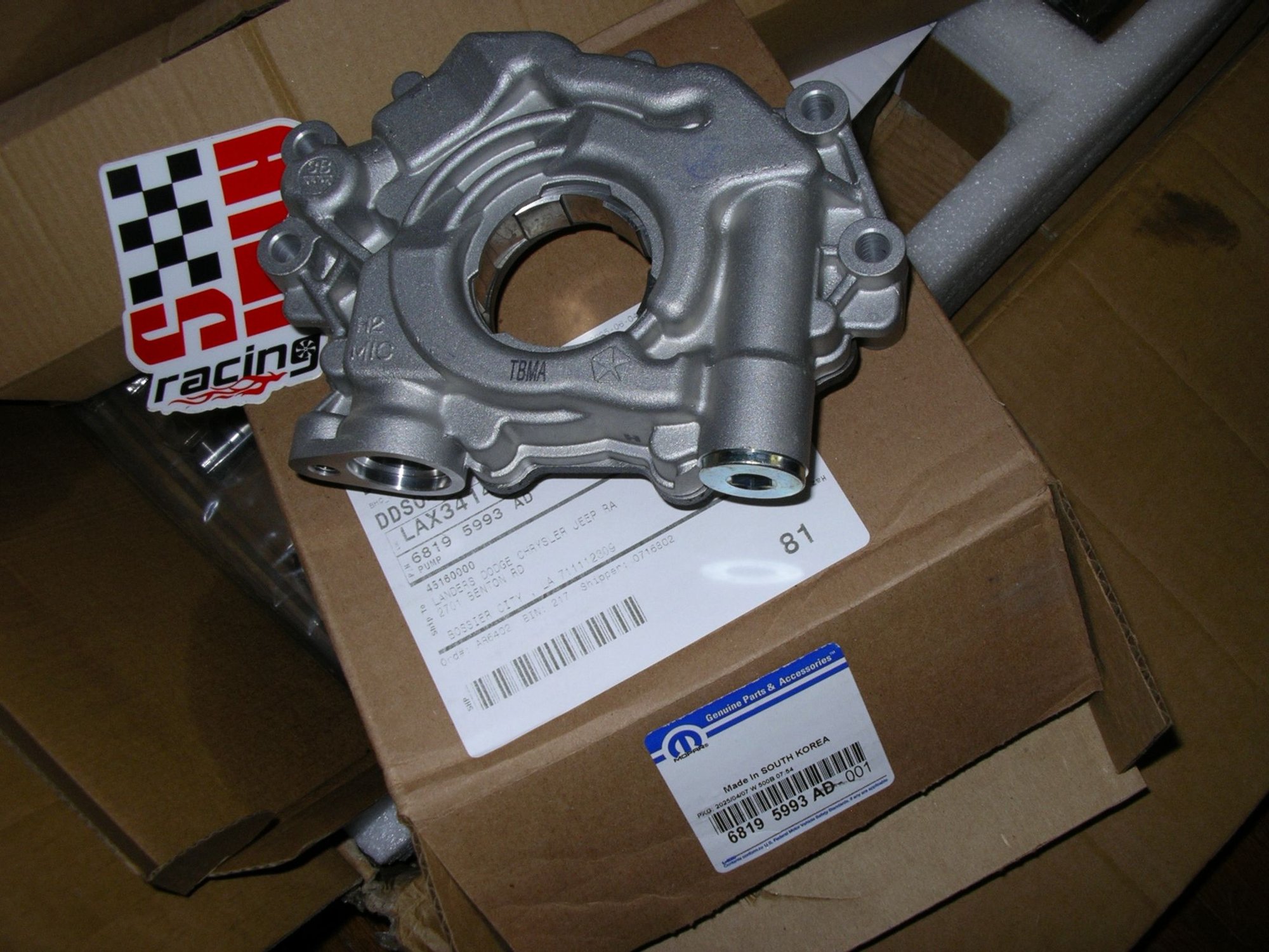

I am starting to get all my parts.
The gaskets, no MDS lifters, HC oil pump, front/rear main seals, valve guide seals, SRT8 oil pan gasket, oil pan, MDS plugs and the SRT8 stock camshaft have shown up.
I got the BGE which seems to be a lower compression ratio version of the SRT8 version.
BGE
BGE
Good camshaft
Good camshaft
Dirty Pistons but clean rollers on all the lifters!!
Nothing Bent - Nothing Broken!
It came with a great cam, no cylinder wall damage, no bent or damaged valve train and two broken exhaust studs on the passenger rear cylinder head.
A lifter I saved from the Jeep 5.7L. I only had 1 lobe on cylinder 1 that was damaged and just enough to cause a misfire. I checked the MDS solenoids and oil control valve and had no shavings. I took a chance and did the cam lifter swap myself. Sold the Jeep after 20k miles of driving it (140k to about 165k).

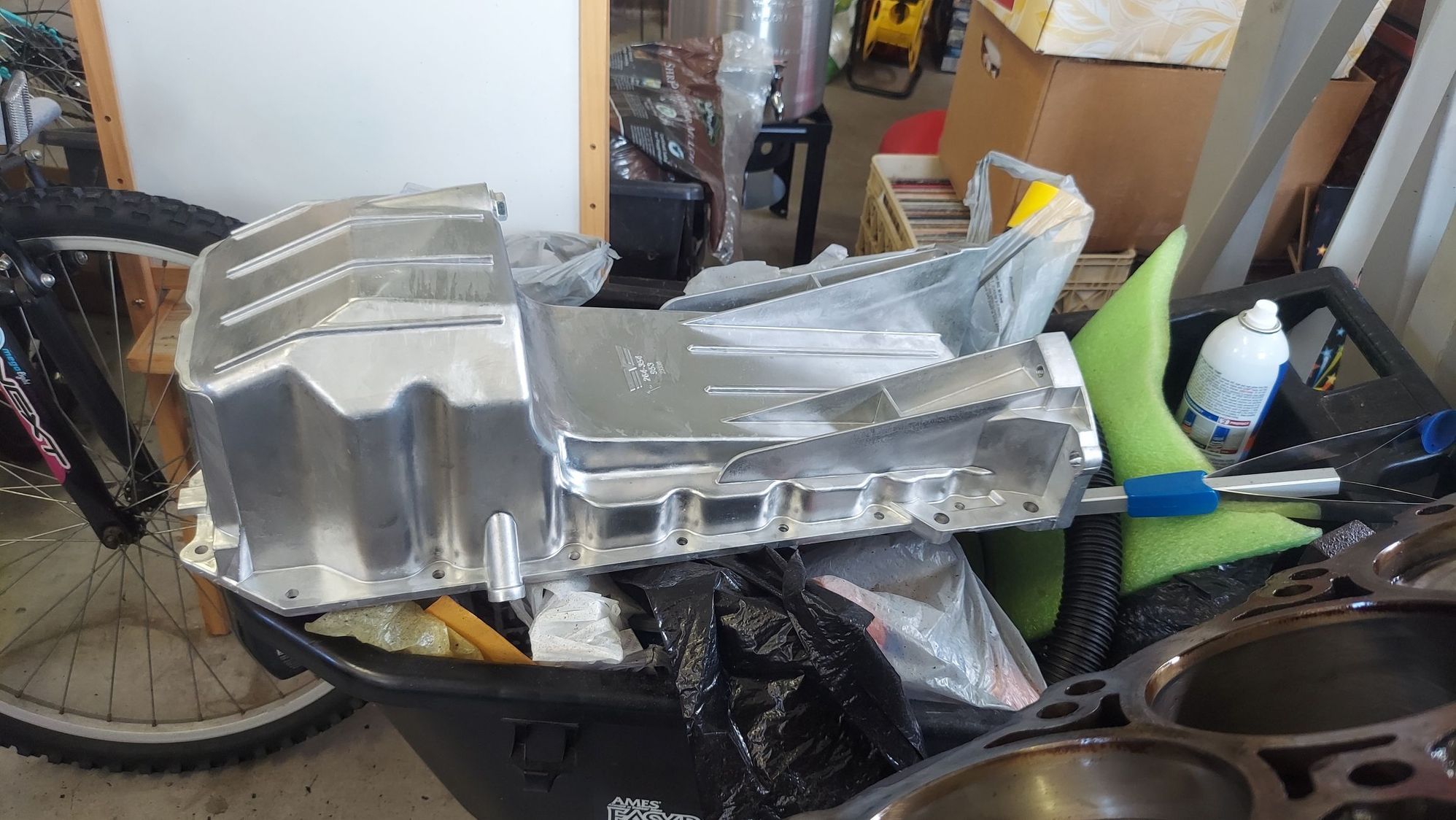

Forgot the oil pan...
I will have to get a freeze plug for the driver side (through the block) port for the dipstick. Oil dipstick goes through the pan on the new setup.
-AS-

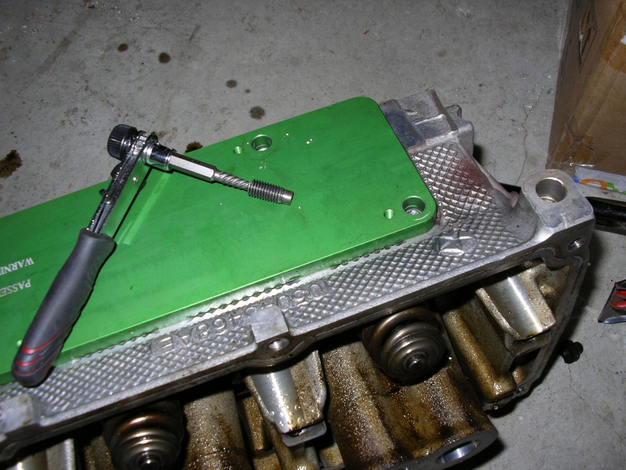

Hello,
I used the kit with the heads off the car. I do know that you can get the green plate in there on the Rams going into the fender well. You can't do that on the Jeep/Durango suv's. I drilled (1/8th drill bit and guide) about 3mm into the studs and used one of the kits EZouts to first, lightly tap it into the hole, then with a ratchet, SLOWLY turn it out... Both of mine came out with no problems.
-AS-

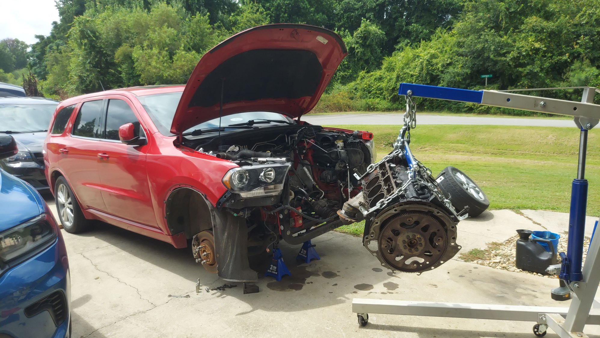

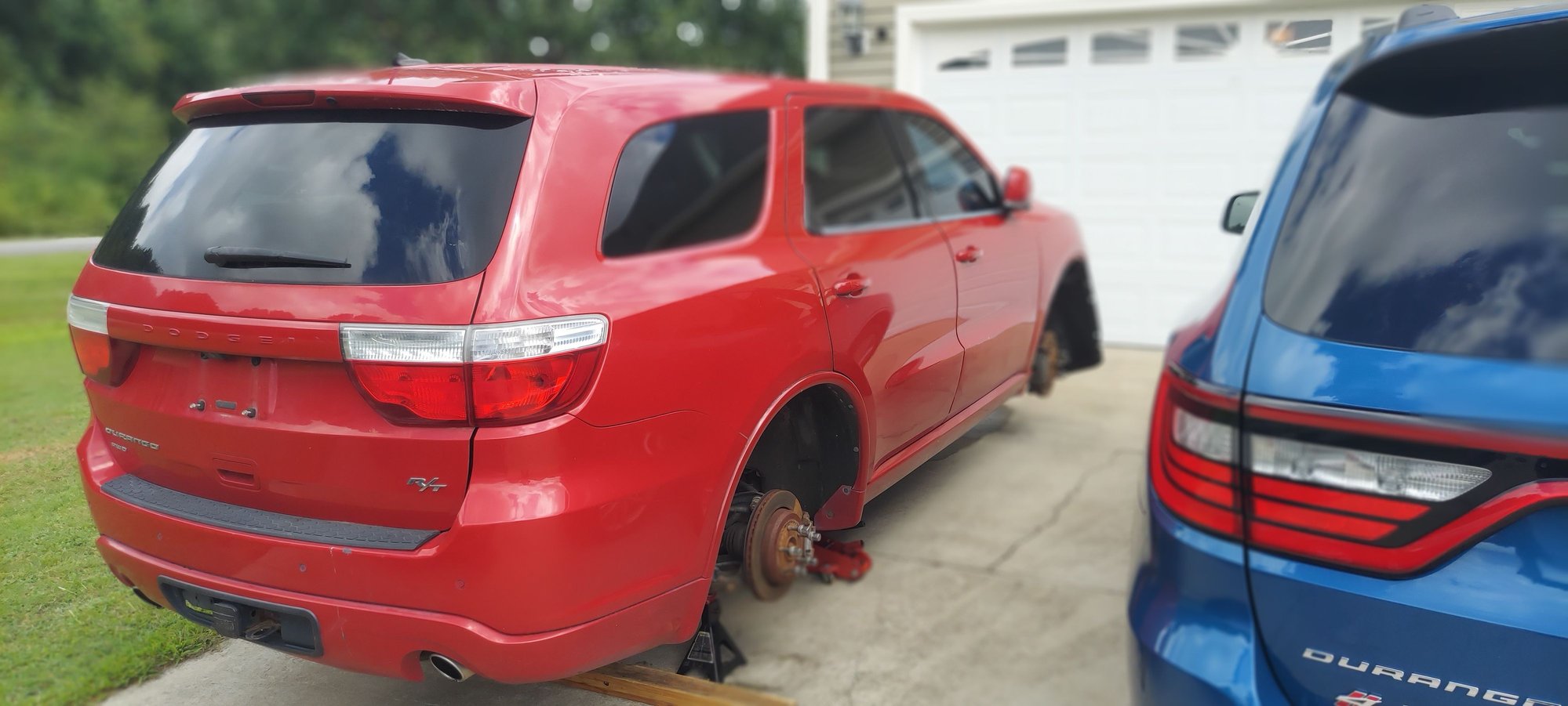

It's been raining and I have been working more so time for the swap fell to the background. I also do NOT have the heads back due to a couple of the exhaust valves that needed to be replaced.
The tired 5.7L hemi is out and as I was tearing it down, I did not find anything too off other than an MDS solenoid that was NOT seated all the way down and a few of the upper engine to transmission bolts being WAY loose.
Here are a few pictures of the process.

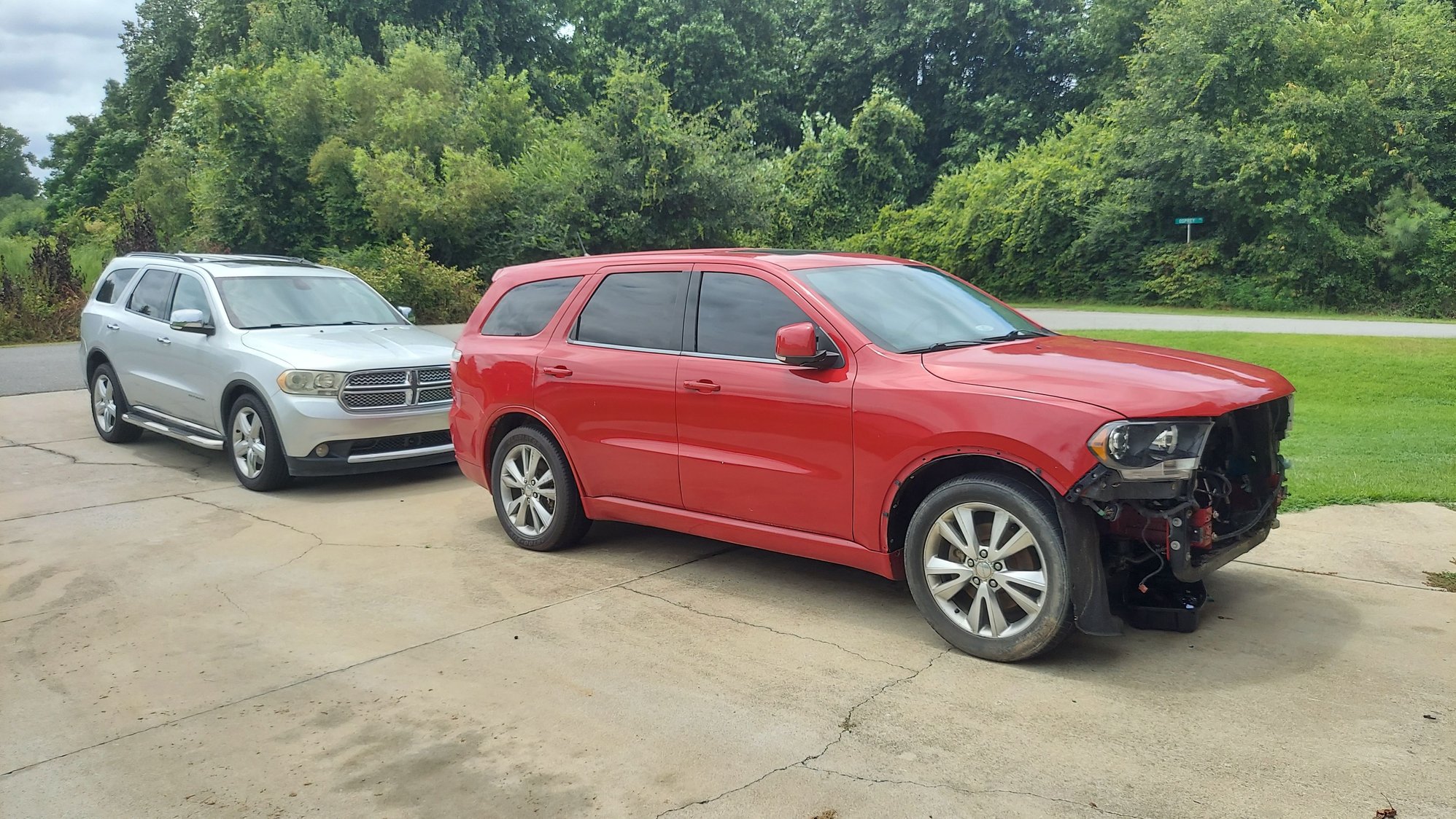

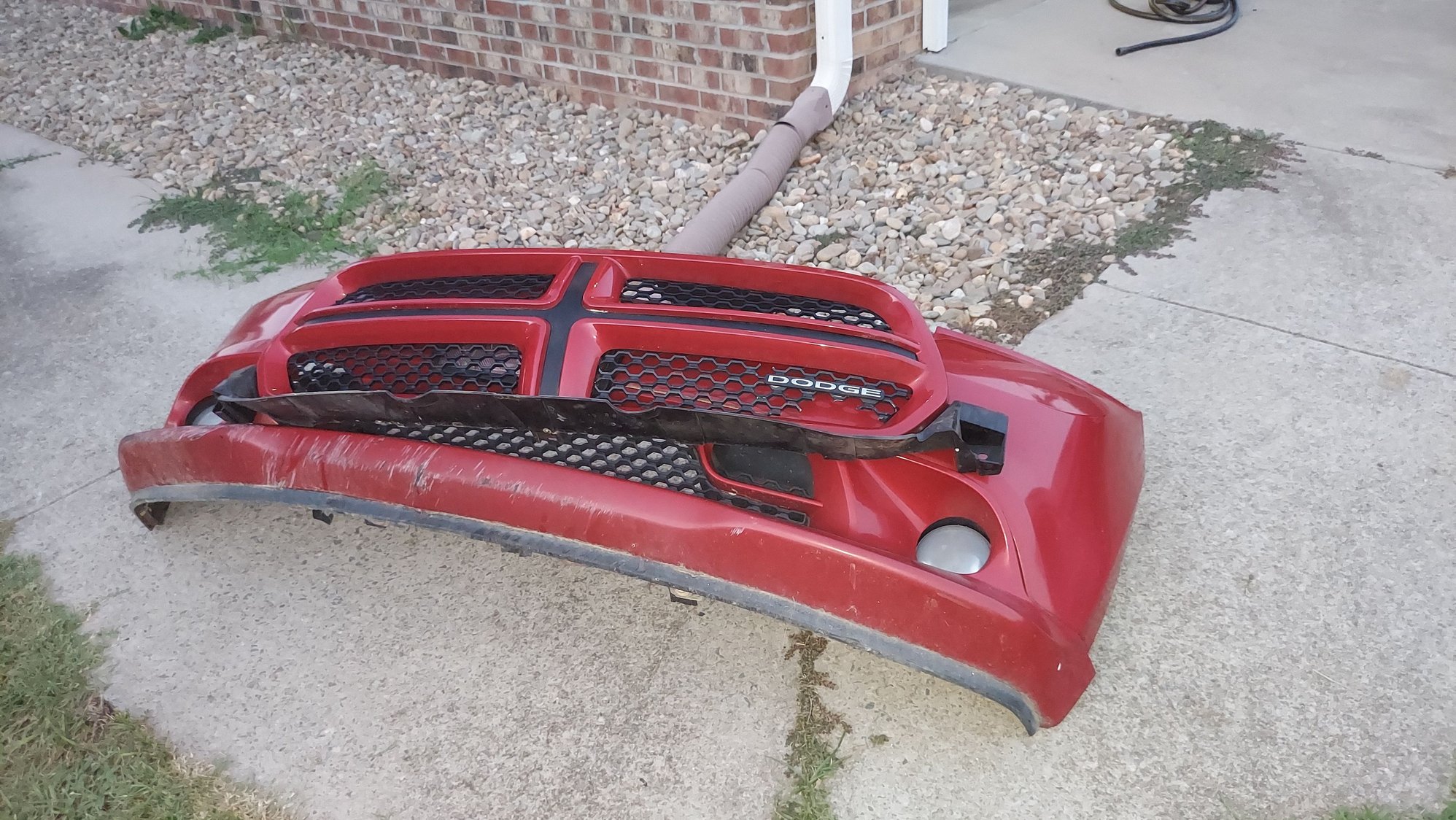

I had to replace the crushed front end.  All I could find for a decent price was a front part with the chrome crosshatch.  I am having it all repainted.  Sadly, I found that I could have swapped the entire front end with the 2014-2019 for about $500 and kept the headlights.  I do not care for the ones with the single LED.  The 2024 I have has the dual LED.  They look better but are not a direct swap to my auto adjusting factory projectors.
Almost time to pull it.

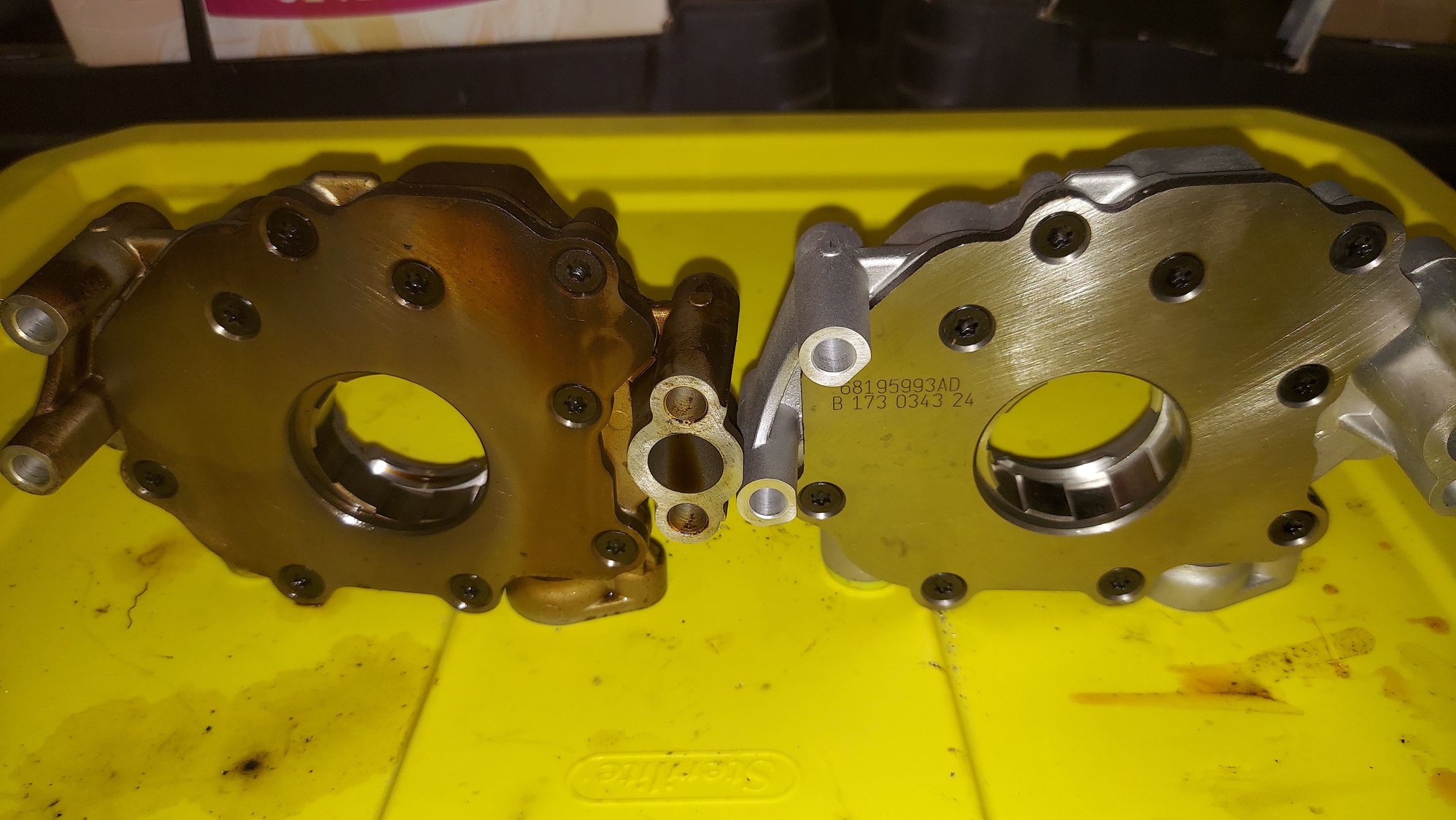

This engine ran but misfired.  It was told to me that the oil pump had failed.  More like the REAR main was just pumping it out the back.  I would fill it up and it would have pressure.  Not suddenly drip it all out the back...

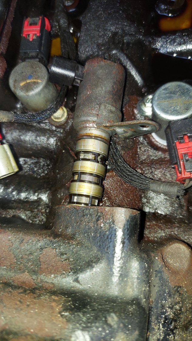

No shavings on the VVT and the rollers on the lifters (MDS) 5.7L were ALL good.  Just the MDS solenoid (on the lower right) and misfire on cylinder 1.

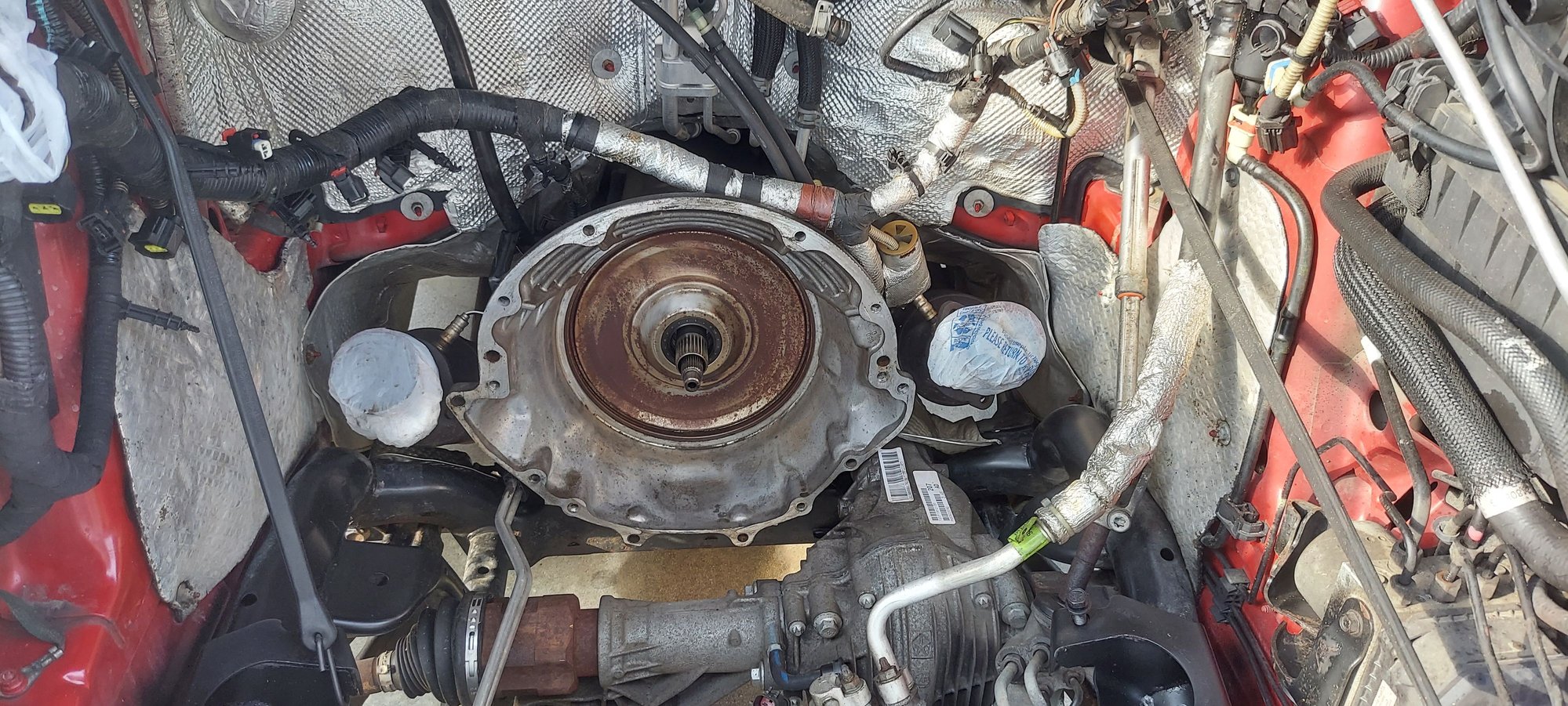

Torque converter spun freely until I did a quick Dawn cleanup to the engine bay.  I popped it out and will get new seals.
Wheels are gone.  With 196K plus, I need pads especially in the front but all the cv boots were clean and not damaged.

The torque converter output seals were not leaking but having that water in there rusted it up.

Ok... Looks like the new oil pan I scored for $90 is not going to work. I was already having issues with the 2012 Jeep SRT8 spec oil dipstick tube and this Dorman pan. I think I know why NOW.
All of the lower bolt holes did NOT line up so a new pan is on the way.
