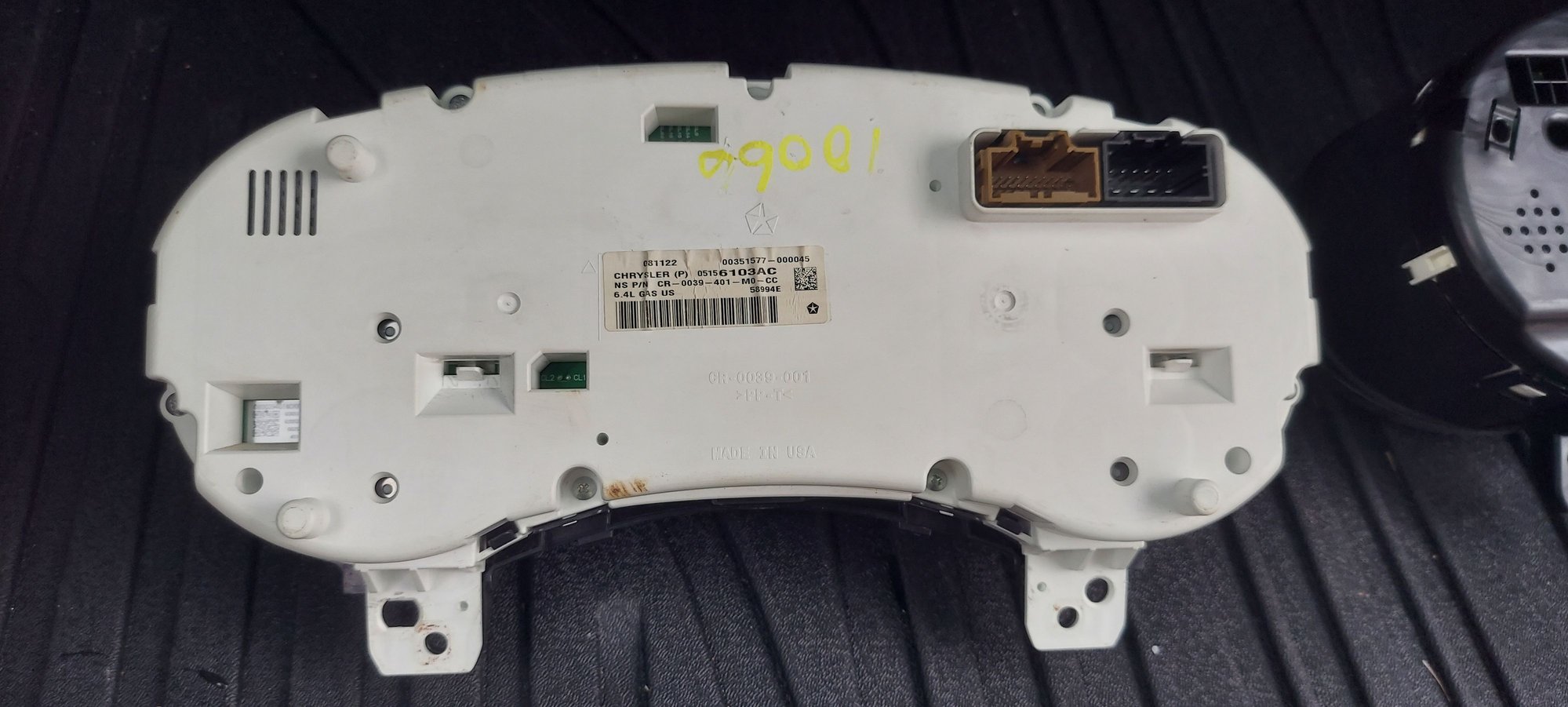

Back of the SRT.  The two plugs are absolutely pin compatible with the standard cluster (this is from a 2012 Jeep SRT8).
Stock unit from my R/T.  All clusters after 2013 have gone to a single plug.  I am not sure if I can use those.
