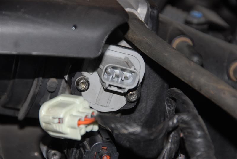

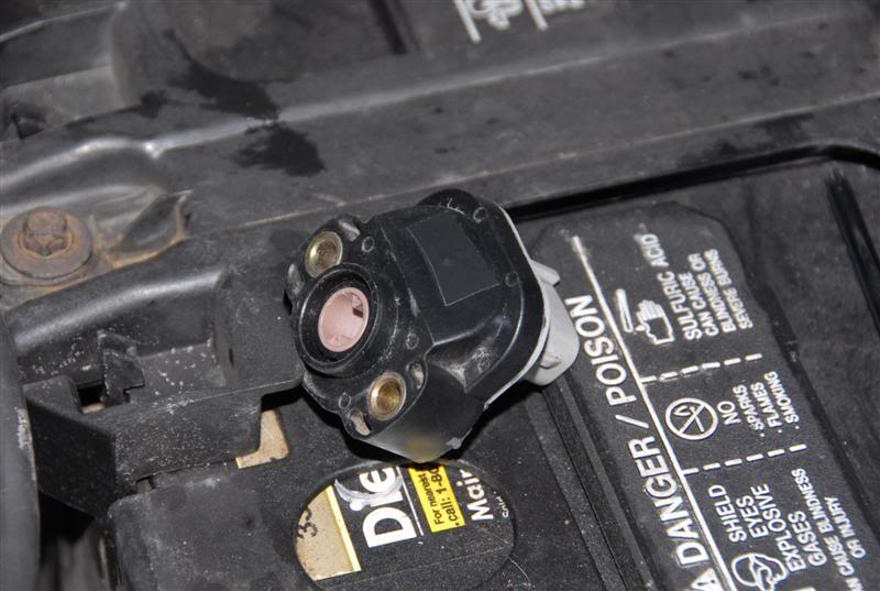

1. Remove TPS sensor from Throttle body

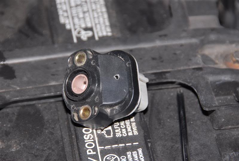

2. Drill a 1/8" hole in a spot where you will be able to spray in CRC Electronic Component Cleaner and the drill bit will not go in too deep too fast.
in other words... drill with a very light hand so you dont damage the contents of the sensor.
