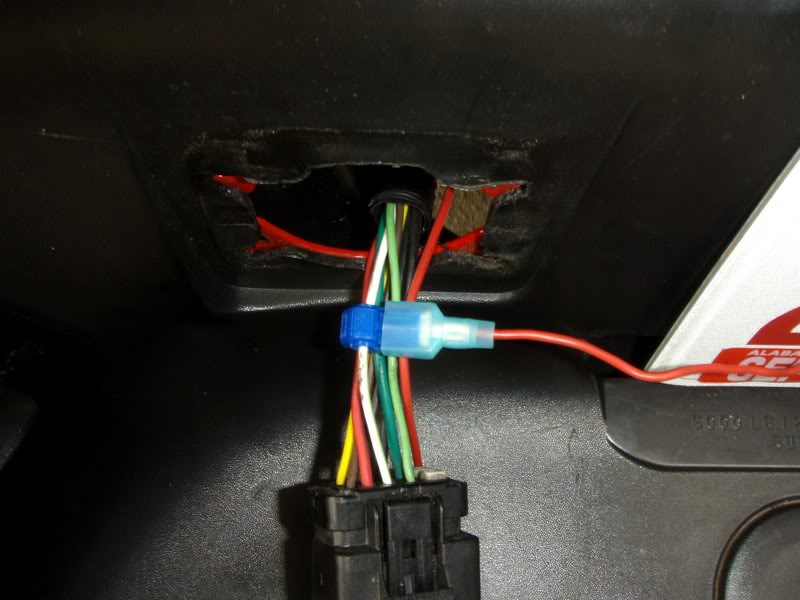

Next step was to find the backup switch wire. I've got the wiring diagrams for the 2007, and I think I found my backup switch connector on the tranny, but the wire colors didn't match. No problem; since I'm running the cam wire from one end of the truck to the other, I just ran another wire and tapped into my 7-pin trailer jack. It's the center wire (white with light green stripe on the 2008).

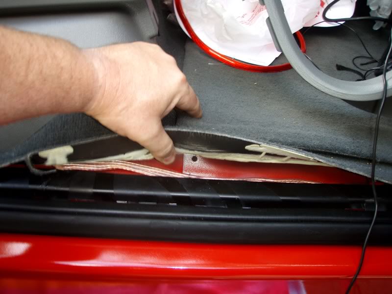

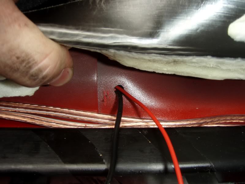

Next was how to run the wires into the cab. After scratching my head while crawling around under the truck, I decided to bring it up through the edge of the floorboard, right above where my speaker wires are running. It's very easy to get to, just pull up the molding and lift the carpet.

The cam came with a grommet for the hole, but I drilled it a bit too small. I wrapped the wires with electrical tape, and filled in the hole with black silicone. Lots of room to run the wires under the truck; if you can't figure out how to route the wires, you've got no business trying to install it yourself.
