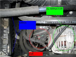

Step #1, Locate the EGR Valve
https://dodgeforum.com/forum/attachm...valve-egr3.jpg

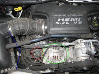

The EGR valve is located on the driver side of the airbox below the alternator. Its location is indicated by the red circle. You will be looking at the TOP of the EGR
https://dodgeforum.com/forum/attachm...valve-egr2.jpg

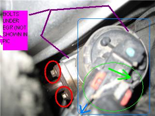

Step #2, Remove the electrical plug and the bolts that hold the EGR in place, watch your knuckles and take your time!!:
https://dodgeforum.com/forum/attachm...valve-egr5.jpg
Replace with the new EGR valve. Also make sure if your check engine light is on that you to go to any autoparts store and borrow a code reader. It's free and will allow you to clear any codes thrown and get rid of that annoying check engine light now that you have your new EGR valve. Any questions about it please email me Directly @ ranch_hunter2f2@hotmail.com and i will be more than happy to assist.
