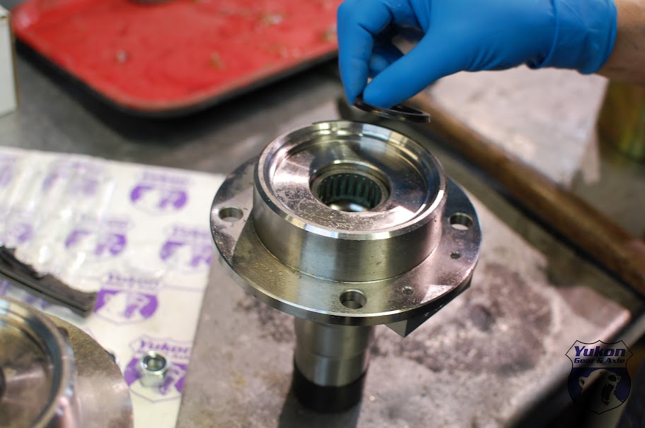

In this picture you can see the .035” spacer under the clip
With the shafts ready to install lets take a look at the components for this kit. We have the new spindles, the hub assemblies, Warn Premium hubs, the 35 spline stub shafts, new Timken bearings and various bolts, nuts and seals. Like I said earlier the customer supplied new U-joints as well. All of these parts are premium Yukon parts, engineered and tested in-house in our facilities in Everett, WA.

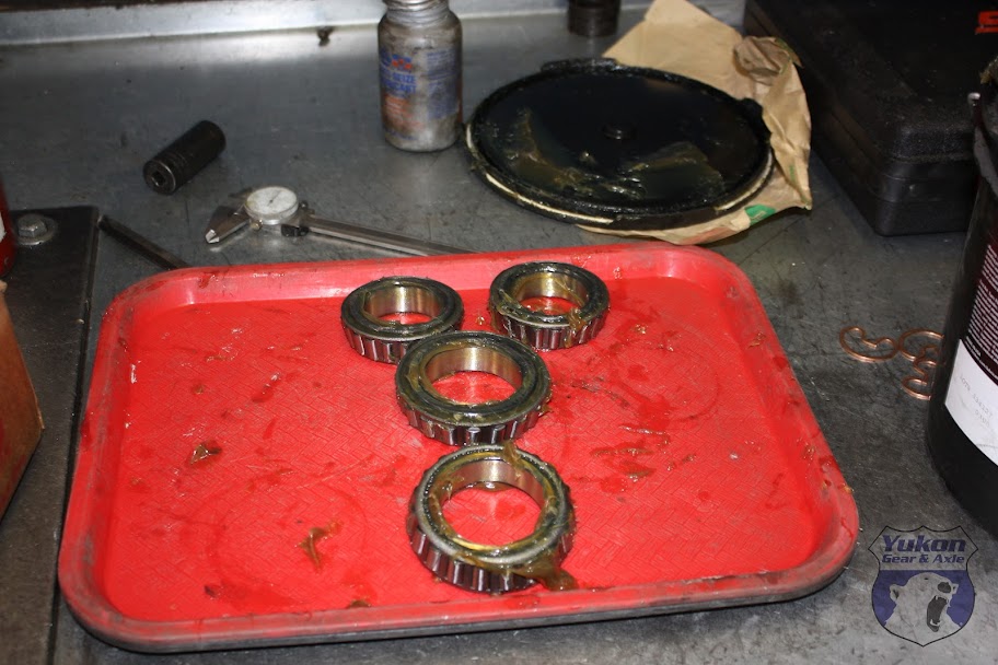

The next step in this install is pressing the wheel studs into the hubs. Using the ball joint press and an air impact made this easy, and having an extra set of hands even easier but not necessary. Once the wheel studs were in place we packed the Timken bearings and installed the seals.

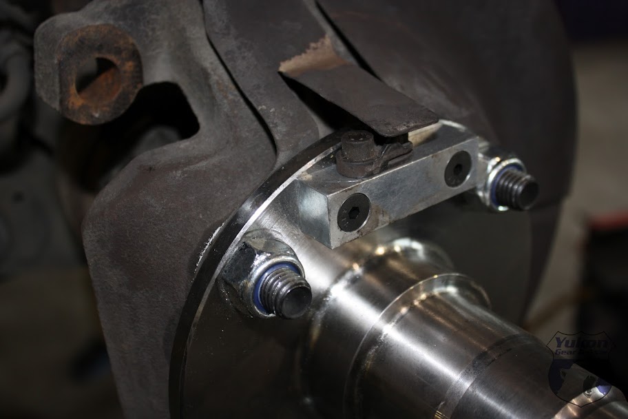

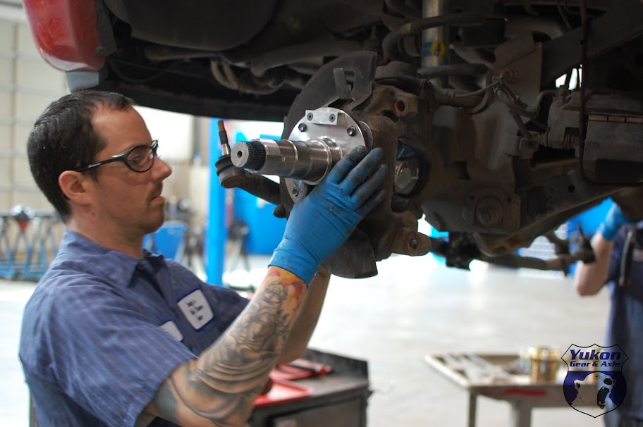

We can now slide in the axle shafts being careful not to pop out the inner seals. The seals are cone shaped and guide the shafts pretty well into the carrier. After the shafts are in we can install the spindles. First thing to do is to pop in the little seal that goes in the back of the spindle. Then you can install the spindles. Make sure you remember the factory dust shields, they go in between the spindle and the knuckle. Four bolts and four nuts supplied in the kit secure the spindle, dust shield and knuckle together. Using an impact we tightened the nuts and bolts. Before moving on we put the ABS sensors into their new home on the spindles.

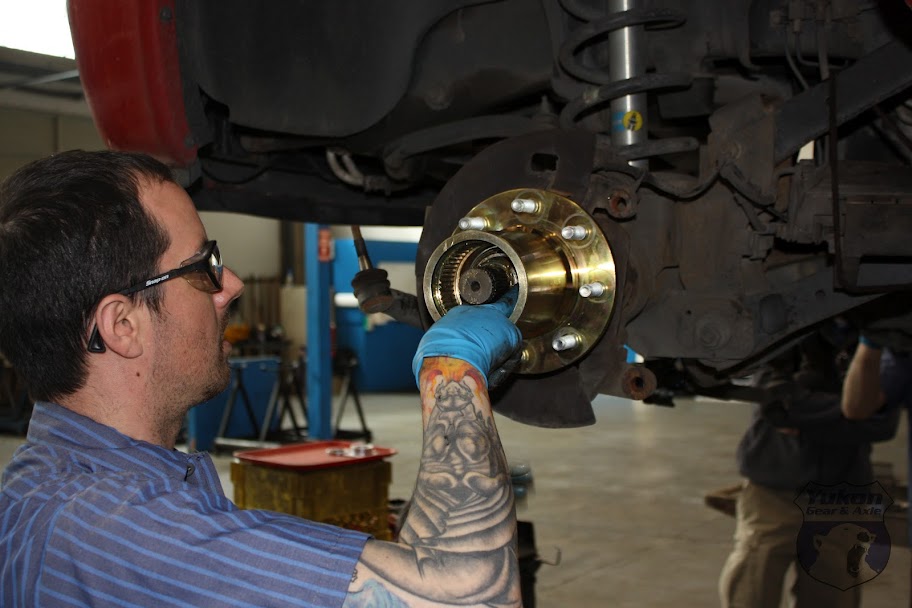

Now its time for the hubs which just slide on. It’s good to coat the spindle with grease while throwing them on to ease installation and prevent moisture from getting inside later. Then we install the locking rings and spindle nut. We tightened the nut as much as we could then gave the hubs a few good whacks with a mallet to make sure the bearings were seated. A couple spins by hand ensured the hubs were tight.
