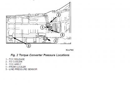

2) Unhook the return line of the transmission. This is the one at the bottom of the trans closest to the pan. I've included a pic below to show you.

545rfe trans pic above
#4 is the return line
