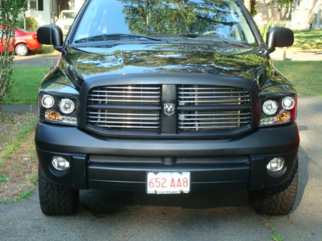

I installed my sport bumper cover today along with projector headlights I bought from K2 motors. The bumper cover went on really easy that I don't know why so many people say it is almost impossible. I used the stock chrome bumper and all the brackets. I still need to paint it as well as my grille, but I wanted to test fit it and see how it looked.

Thanks the bumper cover was $178 + $50SH so like $230 total. Was delivered by some dude in a van and it came From LAX. I bought it from Car Parts Wholesale or Warehouse. The prices are simialiar from place to place either cheap bumper High shipping or vise versa. Very simple to install just disassemble everything except the chrome bumper and slide it over and screw it down. You have to drill a few holes to help secure it better.

I believe it is factory replacement made for the Sport bumper Assembly. I was suprised how easy it fit over the chrome bumper. Most of the brackets are the same as the sport. I did a side by side comparison of LMC 's diagrams and matched up part # on the brackets to see what was the same.
