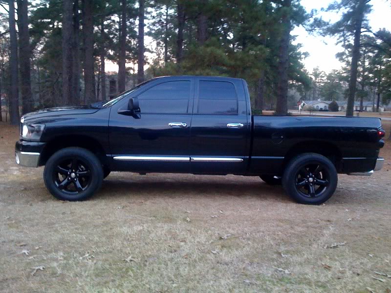

I like the idea of the spacer + spindle and blocks on the rear. I think I will start off with that, and maybe add a body lift in the future when i get the time and more money lol. I really like the lift you got on your truck, it looks real nice. Do you have any recommendations on the spindle/ blocks, like any certain brand?
