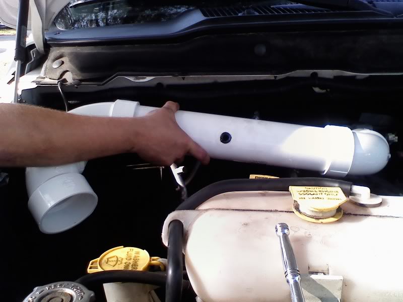

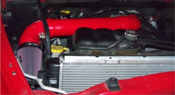

have you made one for a 4.7 liter? the crank case vent hose is long and on the left of the motor. THe hose goes on back a ways. Kinda hard to get to the other end. I dont see how i could but a filter on the hose and just leave it laying there. i guess my only option would be to drill a hole in the pipe and shove it in there and seal it up ????

I think I've done four in 4.7 Rams, plus one in a Dak and one in a Grand Cherokee, so that'd be a half dozen.

oh ok i see... i may just try to get a mini filter. I will rig it up some how. Im going to get some of my materials today. hopefully when i get this done i notice a little bit of gain in performance. wish me luck. i will try to post before, during, and after pics. Thanks hammer.
