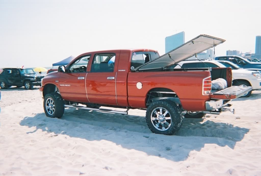

Attached Thumbnails Mega Cab RPM, what are you getting on the highway-tk.jpg

Looks like you have 245/70r17 tires on the truck. That would give you 681 revs/mile.
681*3.73*.67*(70/60)=1985 RPM. A 35" tire would be around 576 revs/mile. If you had those 35" with a 3.55 axle. 576*3.55*.67*(70/60) =1598 RPM.
You old truck was really gear pretty high. Most people would want at least the 3.92 or higher for 35" tires.

HOLY STINKBUG, you need a leveling kit Srg. Haha
