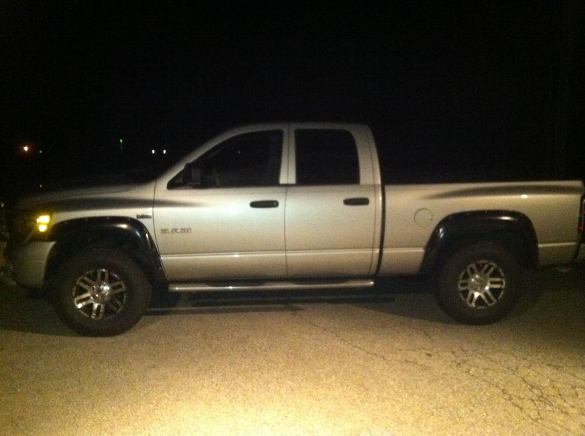

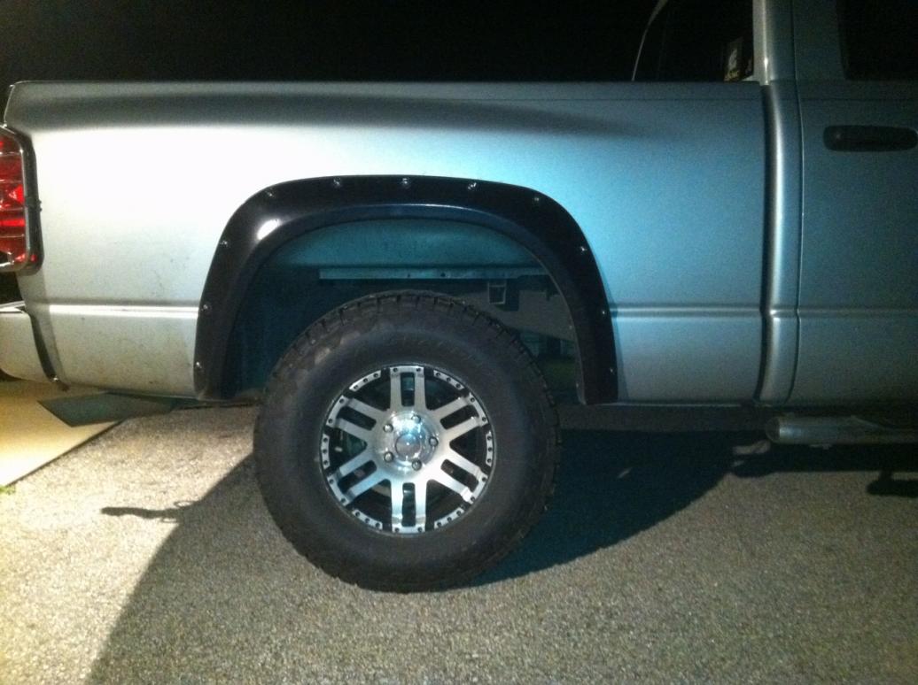

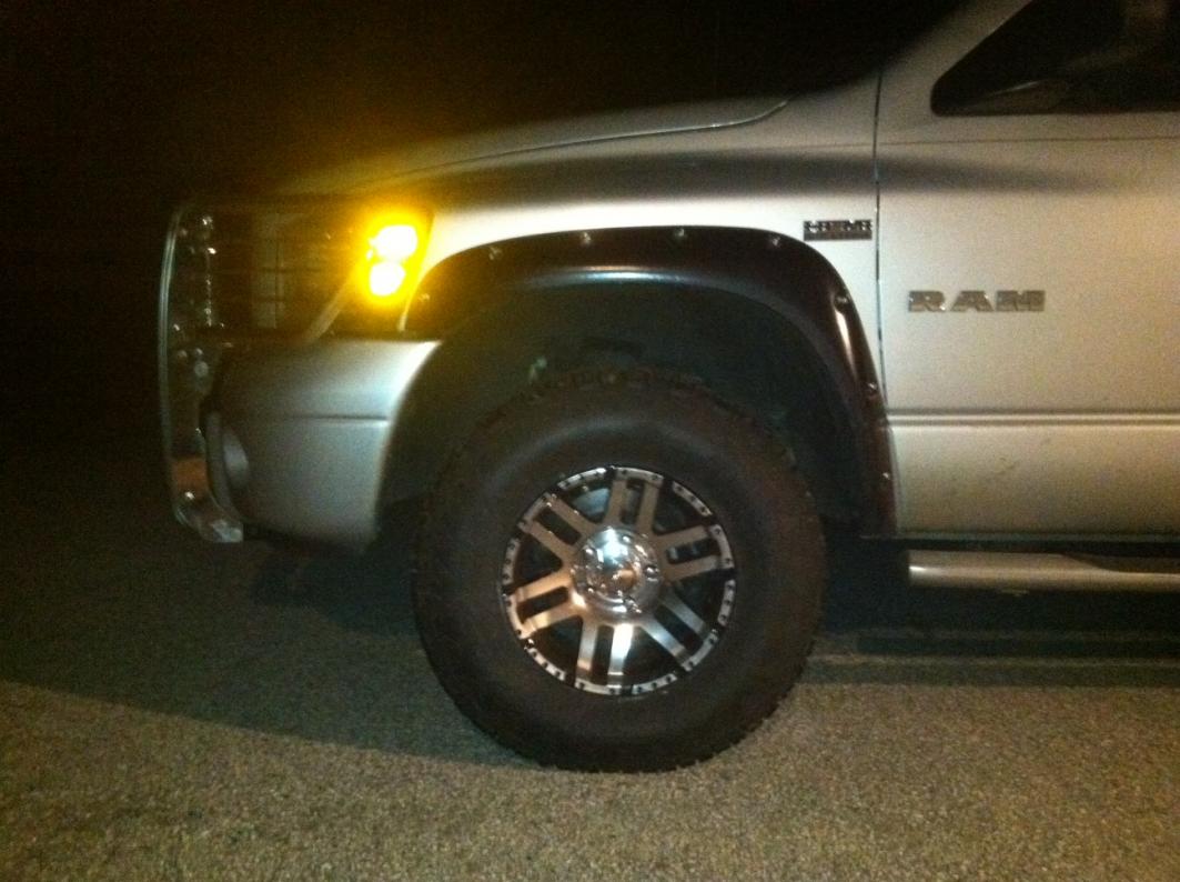

I finally broke down and bought some wheels and tires to get away from the 20" Dodge Wheels. I went with an Eagle Alloy, 17x9, -12mm offset, and a 4.5" backspace. I put a 285/75/17 (34"x11.22") Nitto Terra Grappler on them. I read alot about tires and there was alot of back and forth. I have about 2" clearance between tire and upper ball joint. All I have is the 2 1/2" level on the front. I would say go with the 305/70/17 (34"x12") tires because going from 20"s even though the factory tires are only 10.62" I have alot more sidewall and it takes some getting use to with the tall sidewall flex going down the road.
